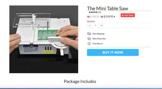

No experience with this saw - but I recognized her
It is the Raitool™ T5 Mini Precision Table Saw
and be careful:
Your offer with 160 $ is for me not looking like a HOT DEAL !!!!

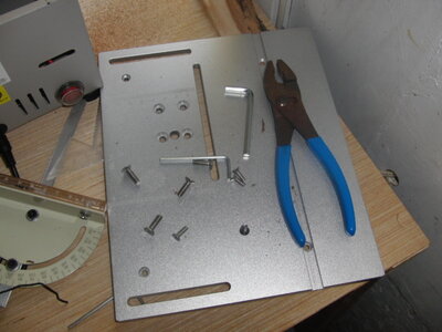

gaining acress to motor and blade requires two different Allen wrenches and 8 screws on the table faceCIMG8611.JPG

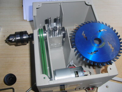

The motor then is loose with no other holding screws and motor and arbor come out loose. the blade arbor is 5-8th of inch and blade is 4" and 1.5mm thick teeth. I am going to get a Micro-mark thin blade
168 Tooth Hollow Ground Saw Blade (.032 Inch Kerf, 3 Inch Dia.) # 80803 and replace the thick blade with a thinner one to cut strips.CIMG8612.JPG
