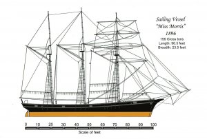

They were used for heavy cargo right up to WWII. The square sails were to help push the ship's head across the wind when changing tack in coastal waters where searoom may have been restricted. There were thousands of them in the 19th and 20th centuries.

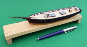

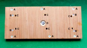

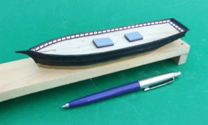

I have now spray painted the sea with grey matt primer (automobile body spray) and then given it a quick dusting of white matt spray just to give it a bit of contrast for the photograph. The final sea painting will be either dark blue or greenish blue. I have screwed it temporarily in the base. The hull has also been fitted temporarily. A hole was drilled through the hole under the main hatch, and through the base. The underside of this hole was recessed with a large wood cutting bit. The photograph showing the underneath of the base identifies the screws and holes. The six screws labelled "A" go into the wedge edging round the sea base, to back up the glue. The four labelled "B" are holding the sea in place. The holes labelled "C" are just holes and used to assist in the removal of the sea base to facilitate painting it out of the base. A screwdriver may be pushed into the holes to work the sea out, as it is a close fit in the base. "D" is where the hull securing bolt comes through into the recess. The hull will finally be held in position with a single nut over a washer. I am now free to concentrate on fitting out the hull, and the masting and rigging. Also more work on the display case between times.
Bob
