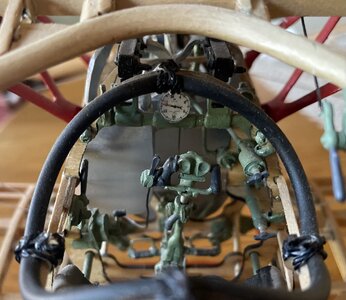

I found some valuable info ito completed pics on the site so decided to share my final build as the instructions included with the kit are not always clear
One of the key issues is aligning the bottom wing at a 2 degree angle to the horizontal.
I suggest attaching the bayonet connection at an angle to the bulkhead as this will align the wings later during assembly
The plan does not show the second pipe from the radiator which attaches to the back of the engine. Also look carefully at the propeller pitch else it may slope to the wrong side
Where to attach lines and pipes is not clear but below my efforts at getting it right
It is easy to get all the controls to work but you need to plan for this from the start - ailerons, elevator and rudder

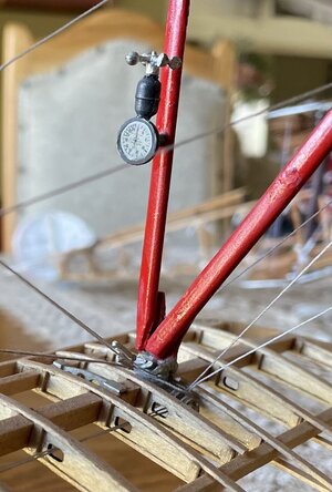

View from below which also shows the strut connection mentioned earlier
