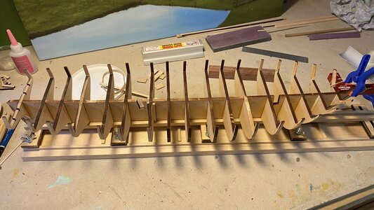

Always a big fan of O.H.P. In preparation for a painting of the Battle of Lake Erie..
I am so glad you posted this picture. I am just about ready to take the first steps on building this ship. I see that you are using the base jig without the other pieces. I wondered while building this jig if it was square enough. It didn't look to be. What was your thoughts?
Thanks.

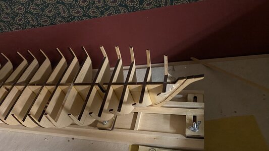

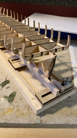

Well, there are a couple of things about that jig that I wish I had the forethought to change..
The biggest is that instead of using the screws and wingnuts provided on the sliding clamp, I wish I had used T nuts and thumbscrews, or at least carriage bolts.
The screws provided aren't carriage bolts.. So they turn when you are tightening and loosening the wingnuts.. Aggravating.
The other thing is that the bow and stern supports are just cumbersome, bulky and get in the way. As is the bulkhead holding apparatus.. So I just don't use them.
The jig can be as square as humanly attainable, I just found it to be more hassle than help. So I use the base only.. When I constructed the base, I used a steel ruler that I knew was straight as a gluing guide.

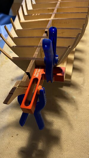

I bought a Woodpeckers aluminum mini-square and then use the clamps to hold it against the keel. Works for me..

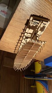

Took a break to fly some indoor free flight over the winter and finish a few paintings. There was also some procrastination in that I was a bit daunted by the stern blocks that had to be carved. But good sharp tools and taking my time and they are nearly done. I had forgotten how satisfying carving wood is to the soul.
