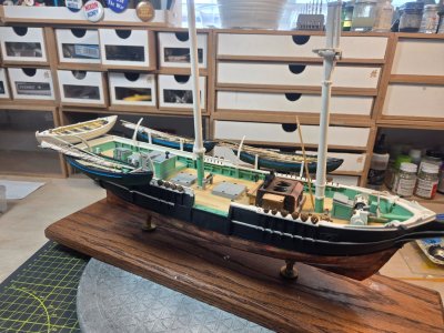

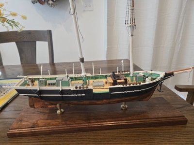

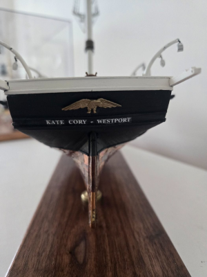

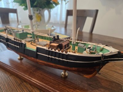

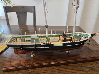

Finished coppering the hull and then mounted on a temporary base. It is important not to use a cradle as it will damage the plates. The thin wood strip is a "wood guard" added at the water line as noted in the Whaling Museum plans. Next step is to finish the rudder, hinges, and give the copper a good cleaning before airbrushing a coat of Dullcote lacquer.
This stage of the build was very time consuming and I am anxious to start on the deck structures.

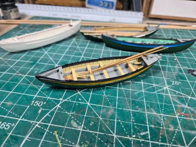

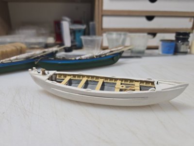

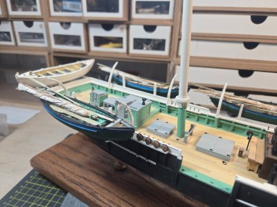

Some clarification on the Kate Cory whaleboats, there's no right or wrong design. The kit plans offer little detail regarding the whaleboats and notes they did not have a centerboard. Nor do they show any detail regarding a rudder. Kate Cory plans from the New Bedford Whaling Museum provide no detail about the whaleboats. The ship has four whaleboats, three working and one spare carried at the stern, which was not painted, simply primed "white" which was the custom when delivered to the buyer.
As I went through my research material it became increasingly confusing and difficult to pick "one" design. The book "The Whaleboat by Ansel" contains a great amount of detail and options, for example note the variations in rudder and lions tongue designs in the photo. The book also notes that whaleboat design was constantly evolving, earlier versions did not contain items like "peak cleats", there are numerous mast head design variations, etc. So, obviously, there is no one design. Consequently, I decided to use an old set of Marine Model New Bedford Whaleboat plans a basis to build a prototype.

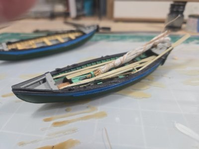

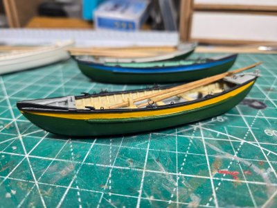

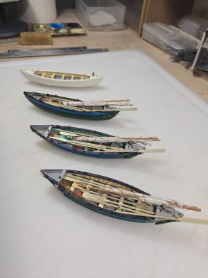

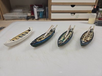

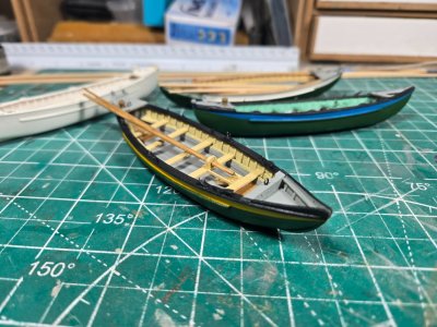

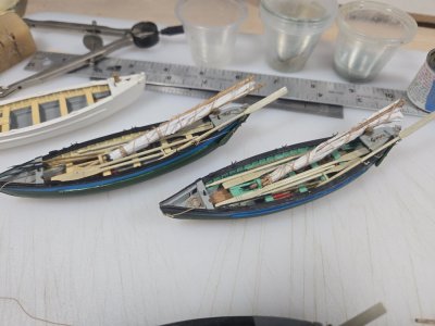

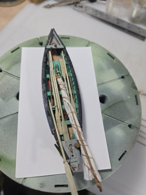

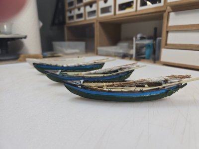

Making progress with the whaleboats. Completed one boat as a prototype before moving on to the others. Will now add the rudder, sail and gear. Thanks to Tom Lauria for posting his YouTube videos, many helpful tips, specially making oar locks. Also, will try his sail making technique.

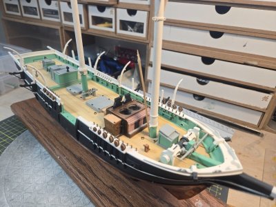

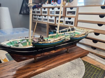

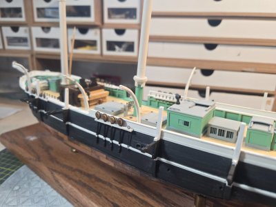

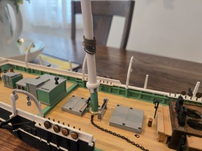

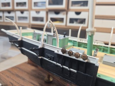

Haven't posted any updates recently. At this point I am finishing up the standing rigging. Saved the ratlines until last! If you are building this kit or something similar, I would strongly recommend completing the whaleboats early in the build. Aside from the obvious placement of the davits I have had to place them on the build to make sure they will not interfere with other additions, they clear the deadeyes and shrouds, etc.
Have studied the rigging plans, the kit plans are fairly basic, but I think provide enough detail for a good build. Fortunately, the Whaling Museum plans have an index of block and rope/rigging sizes. Also, they provide very detailed belaying points. For rigging I'm using rope and "wooden blocks" from Syren. The blocks are more representative of those detailed in the Museum plans. Also, Kate Cory uses a variety of iron strap blocks which I found at Bluejacket Ship crafters.
