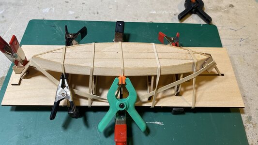

I start in earnest…

You're off to a good start. These kits have good instructions; easy to follow. Plan sheets are also good. I built all three starting after I finished a couple of other kits; also worked on some non-ship kits in-between the boats. Variety keeps things interesting and the skills learned doing one type of kit are transferable to other types.
Good luck with the build. Most importantly, have fun!

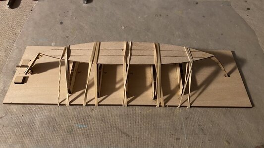

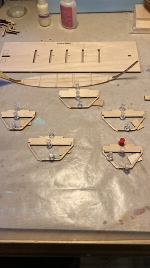

Had the opportunity to build some tonight.
Stem and stern.
Those frames are well done. Is the panel above each one a spacing jig for their construction of somehow a part of the dory? Out here in Western Oregon we have dories modified for more rocker, McKenzkie River Boats for running the rapids along that river and make good fishing boats to boot. I'll follow your log. Rich (PT 2)

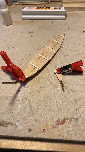

This evening….
It's part of the building jig.. I'm very impressed with how Model Shipways designed this kit.. They made it so that you really have a good opportunity to have a really successful and nice looking result..

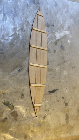

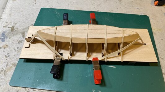

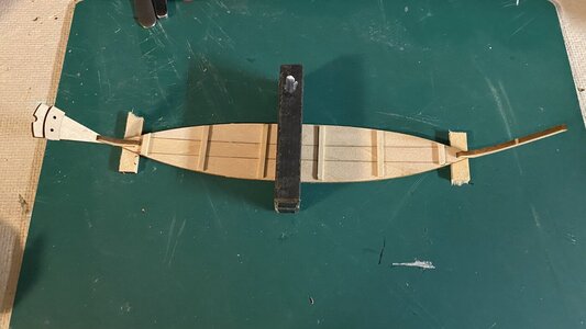

Garboard planks drying after being soaked. I’m going to let them dry overnight before I glue them.
An option to water which expands the wood fibers, is denatured alcohol. It is absorbed much more quickly than water and provides easy heat bending and setting without the water expansion. Just a suggestion to try sometime. Rich (PT-2)
