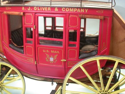

This model marks a transition for the builder, whose hand tremors now preclude me from the 1/48th scale biplanes that occupied me for almost 50 years. It was completed over a period of months in 2024 and 2025. It is the first wooden model I’ve attempted, and I found the transition both entertaining and relaxing, as hand tremors are actually useful for sanding! As a first kit of this sort, I benefited greatly from the outstanding materials, plans and instructions included in the package, and would recommend this to any novice, even ahead of simpler subjects that are not as well presented. I’ll limit my remarks to the modifications I incorporated or particular matters I deem of importance to success.

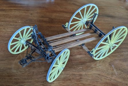

I determined early on that a more modestly decorated vehicle seemed appropriate for territorial Montana, and enabled me to skip elaborate pin striping on painted running gear, and limit fancy work on the coach and wheels. I stained the reaches and axles brown and used chemical treatments to blacken the white metal and brass components. I wanted to portray sufficient wear to make the coach look “used” without being dilapidated. If and when I build a buckboard, I’ll make it dilapidated.
