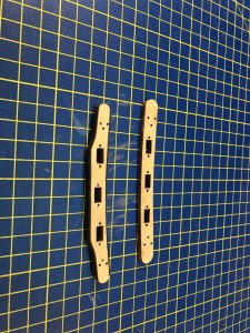

After studying the plans and the work book the build sequence seems very logical. I was looking for the “aha!” moments and it seems the work book has highlighted many of them. I’m impressed so far. I will start on the frame assembly. I started on the 3 reaches, chamfering edges, drilling required holes and attaching bolts. The kit uses a rubbery type material for the very small nuts. Clearly a cost saving move that I get. These parts are so small once painted they will look authentic. I’d rather the mfg spend money on high quality wood and laser process. It seems on this kit Model Expo has focused on the right areas. 8F3DBEDC-942C-42FC-ABCA-A8F086C725C8.jpeg

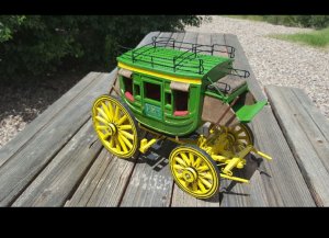

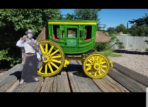

I had my wife send me two photos of the scratch built stagecoach I made as a means of showing you possibilities you will have on your build. Mind you that the photos are a bit blurry but it is the best I can do for now.20181229_222116.jpg20181229_222137.jpg20181229_222158.jpg

What you have so far looks great. I especially like that the metalwork is readily available with the kit. I also had to scratch build those which meant cutting the brass strips to size, bending them to the correct shape, soldering them, filing them down with small files, and finally painting them. Mind you, that process was repeated for every metal piece. Was I a glutton for punishment? You betcha Buddy!!! ;)

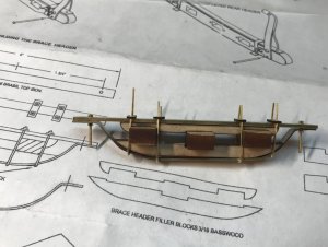

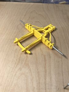

I made some more progress assembling the front brace header. The kit provides two sets of upper and lower brace header fillers. One set is used as a jig to assemble the top and bottom irons and bolts. The other set is used on the model when this piece is added. This made the construction relatively straight forward although tightening the bolts was a challenge. The piece will be disassembled when applying to the under carriage assembly. Working on that next.D7756DF4-A6E0-4240-9266-94E4E64F363A.jpeg

Hey Buddy,
I am so glad that you are continuing to progress on your stagecoach. I like the view of your axle. When I did mine, I had no clear way of making them so I improvised and made it work. Seeing how it is actually made is nice so thanks for posting it.

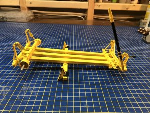

Lots of painting over the last two days. First I primed all the undercarriage components with white and then two coats of yellow. I also assembled the completed components (three reaches, brake system, brake beam, front and rear brace, rear axle with brackets and supports as well. The brake lever is just loosely fitted. I will not permanently attach it until the final stage.
Here are a couple of pics of where things are so far Next up will be the running gear. 5A9B40EC-86A9-4876-BBFB-0D62989412A4.jpegD7B1383C-4EEE-4A59-BFB3-CDA229C69EC4.jpeg
