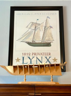

Modeling a Baltimore Clipper
I bought a kit for a Baltimore clipper by an Italian manufacturer named, Carla Augusto in the early 1980s. I finished the framing, but never got to actually planking it. It sat on the top shelf of my closet the last four decades. The long story is I’m a very eclectic modeler of historic boats, planes and then a serious deep dive into scale model railroading.
This kit with four pages of drawings, but little directions for construction. Back in the 80s I did subscribe to Ship in Scale for its first four years or so I am some print resoures, before getting into RC sailboats and then an actual full-size sailboat. In the late 80s I got into a model railroad layout during the winter had sailing during the summer. Whether my problem is curiosity or the attention span of a squirrel, I have kept up my interest in the Baltimore Clippers over the years, visiting the pride of Baltimore and the Lynx that I’ve seen in a couple harbors.
My goal in completing the model is as a generic war of 1812 privateer. Whether I will ever finish it at my age is a question not of a great concern to me. My immediate problem, as a scale model builder, what is a scale of this kit? There are no hints on or in the box. I assume these kits were built mainly to fit on a the size of a shelf, and the scale was not important. Which raises the question for whether a kit like this is worth finishing?
The length of the deck is 22 3/4 inches by a beam of 5 1/2 inches. The three or four plans for Baltimore Clippers, privateers in the war of 1812 from Chapelle’s book suggests it is around 1/50. Does that make sense?

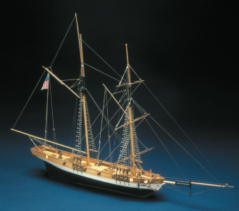

Hi, and welcome. Just for information: Mantua/Panart has a kit of the Lynx (scale 1/62) in their catalogue. As your kit really isn't very much advanced yet, it might be worth considering to just start anew instead of messing around and, most probably, just getting frustrated with the old dreamboat.

Thanks for an alternate approach. The model seems like a good effort to come up with a named ship we have some drawings of and looks like a kit that is much better to work with.
What I really have is no more than "a box of parts." One thing I did learn in model railroading was the concept of "kit bashing" which was simply using a box of parts to build something else, which I often used for representing historical structures on the layout. Probably the best I can get out of this old kit is a "representation" of Baltimore Clipper from War of 1812 era. I did download the booklet for building the Pride of Baltimore which would help build this kit without directions, but buying the Mantau plans/directions for this Lynx would be another option. Thanks again for the leads.

Thanks for the photos. I also had the opportunity to tour the Lynx in Saint Pete. It is shorter than the original drawings, and the deck is completely different to allowed to be used for educational and tourist purposes. My understanding of the design of the original Baltimore Clippers was that the decks were open and largely free structures to enhance speed and the needs of battle. Speed was their main advantage to escape British warships.
Like most replicas, Lynx only superficially resembles a Baltimore Clipper. If used to sail with passengers, USCG, insurance, and other regulations require modifications to the design. Also the 1990’s sinking with loss of life of a Baltimore Clipper replica that faithfully reproduced the designs of the real 1812 schooners convinced the “Tall Ship” community of the dangers of sailing these high performance vessels with modern day crews. As a result, the underwater shape of Pride of Baltimore II has been drastically changed to improve her transverse stability.
The photo of the painting that you posted above shows that either the kit designer dreamed up the design, or Linx’s modern day designers drastically modified her hull. That extreme cut away bow looks like a 1950’s yacht hull grafted on to 1812 Topsides. Of hand, it appears to this small boat sailor that sailing her with a full rig world produce a nasty lee helm. A dangerous situation
If you are interested in Baltimore Clippers, compare kit designs with drawings of real vessels in Chapelle’s book. I would not waste valuable time on this kit.

The picture of the Lynx in the poster was sold on the Lynx itself on tour. It is a painting of the current vessel and one would think based on its design.
The hull of the kit in question looks similar to some designs of historic Baltimore Clippers in the Chapelle book and other models on the internet. No doubt the original designs were living on the edge for speed, and as you said, difficult to sail and often lost at seas, as was he first Pride of Baltimore.

Be aware that the Lynx is NOT a Baltimore clipper, or a "reproduction" of her name-sake.
Either you build a model of the boat that exists today, or an actual Baltimore Clipper, the two are alike in name only.
Here's a drawing of the 1812 boat to compare to the picture you posted. That's just the hull, there are massive differences in the rig as well.

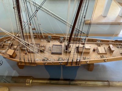

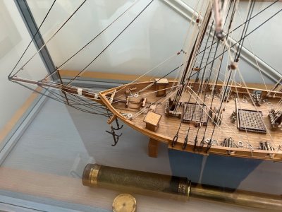

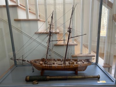

If you have the old Ships in Scale magazines check out the series that I wrote on construction of the Harvey modified for a typical Baltimore Clipper. I had a set of plans from Chappelle’s book plus about a hundred pictures I took of the ship when in Baltimore harbor. The articles I believe were run as a series in the 80’s hope this helps LouIMG_1017.jpegIMG_1018.jpegIMG_1019.jpeg
