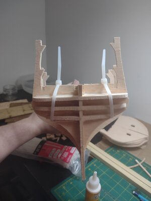

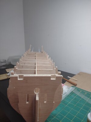

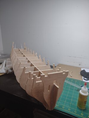

This one is as big as my back seat which is crazy. I have been looking at logs and diagrams for weeks and once I got the ship home i did the normal check over the whole kit and found that unlike most of models where it's a set of plywood for the skeleton this kit comes with particle board. It's lighter but it doesn't feel as strong which leads me to believe that is why most modelers use balsa blocks in the slots in-between the bulk heads. IMG_20220416_203324055.jpgIMG_20220416_211432891.jpgIMG_20220416_211438324.jpg
Nice aligned and doing an overnight dry so I can start in morning on the deck. And start getting some next steps done.

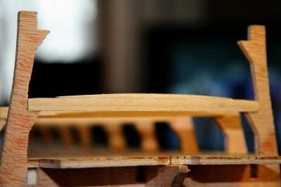

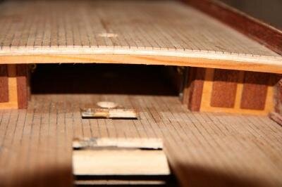

For sure that is the plan but there is another issue with this ship as I have been looking over some build logs I have come to find that, atleast on the top deck, there is an arch to the deck from mid to outter decks.
It is kind of hard to see but from the sloping I am assuming this is to keep water from pooling on deck and help to prevent issues from occuring with choppy seas.
This is the only reason I see for the thickness I got for the deck planking. It's more of the width I was questioning but doing some calculations, I found that 4mm-5.5mm is around what my scales planking should be.
Normal planks are 12" - 16" wide roughly which at my scale is about .17"-.22" which correlates to the 4mm - 5.5mm.

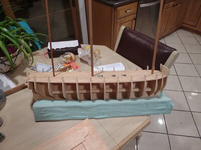

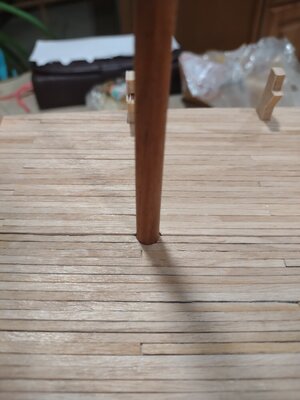

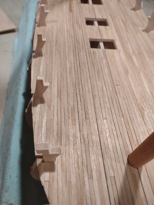

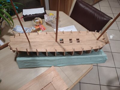

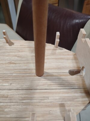

Now I have gotten the first dry fitting done for her. Still much work to do on this part but want to make sure I keep this in mind and make sure that it all aligns. IMG_20220419_212956927.jpgIMG_20220419_212952768.jpgIMG_20220419_212925596.jpgIMG_20220419_212230331.jpgIMG_20220419_212221889.jpg
I did staggered planking at 5cm intervals in sets of 5 with 30 cm planks. The soft pencil coloring did not show through like I wanted to so I'll make sure to make the markings darker on the top deck. Still a lot of work because I need to do the treenails which I'll do out of toothpicks. Then sand her down to 400 grit and put a nice coat on her of dark walnut stain.

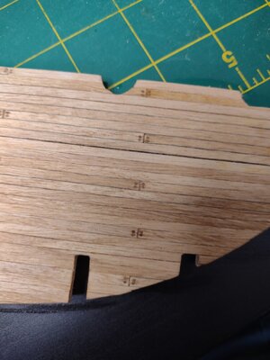

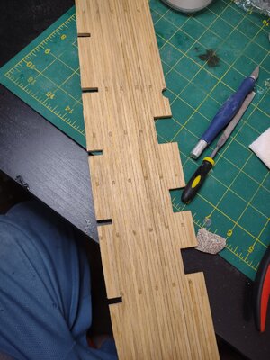

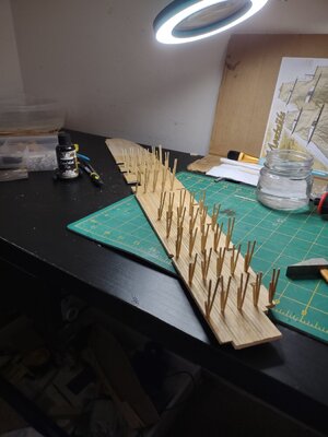

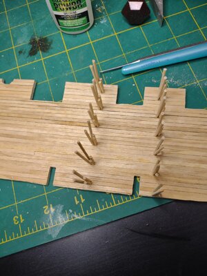

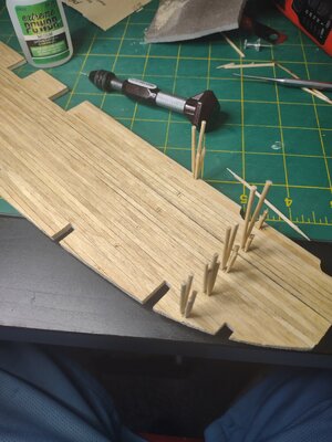

Alright so I have been going slow and steady and I am feeling so good about this. Started out with drilling down with 0.5 mm drilled holes and used some treenails(good ol toothpicks lol) and glued and sanded them down. IMG_20220420_181511337.jpgIMG_20220420_222639022.jpgIMG_20220421_190954190.jpg

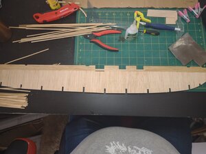

Then I used a water/soap mixture to do a clean over all the work and this is how it turned out. Sorry for the bad lighting be it's dark lolIMG_20220420_222631912.jpgIMG_20220421_200759101.jpgIMG_20220421_200812036.jpg
I'll do the other half and then I'm going to do the stain all at once to make sure it's nice and even.
Two suggestions bro. the treenails have to also go in the planks anywhere a frame would be underneath. You'll have many lines of nails going across the deck. The dark walnut stain,,, ? I wouldn't stain anything until you know exactly what colors and shades the other parts of the ship will be. Normally the deck is a light color, lighter than most everything else. That kit contains beautiful wood. It would be a disservice to stain or paint anything unless you really have to.
