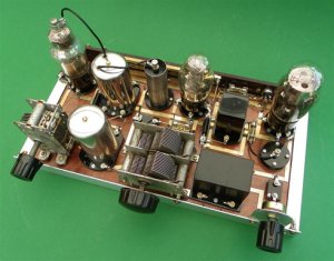

I don't have an I-Phone! :lol: Generally, I dislike modern technology, although I do like using computers, scanners, printers etc. If I design or build anything electronic, it is is only with valves (or tubes as they are called in the US). Quitting the electronic "rat race" in late 1992 after 32 years, was one of my better decisions! But in ship modelling, I prefer to be more up-to-date, usually from the 1890s to about 1965, :cool: where most modellers seem to prefer to build much earlier ships.
Bob
