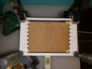

So I went and had the top board file reprinted today because I screwed up the template for the first set i had printed, now it wont print to the right size even though it's being printed from the same computer onto the same print machine. i had a lengthy argument with the printer person at staples over this what's bad is I already started cutting the wood from the first set of plans, here is the plan on the correct size board with a measurement of the size. So I guess I'm not building this or I have to figure a way to do it where I dont use the top template and jig. I dont want to have everything reprinted to this smaller size as wood has been cut and I'm not willing to waste the build board bottom that already built perfectly square and frames cut out or poplar. Even the first set it prints were off from the written measurements the build board top came out to the written measurements are top board 13 5/8 X 8 15/16 the print I got the first time measured 13.5 X 8 7/8 so that was close enough and everything else is printed to those dimensions. Any clue what I can do for the top board ?? I had it reprinted today 3 times and every time it measures the same wrong size printed 1to1 20181006_100919.jpg20181006_100929.jpg

Ok so here is my solution to the problem I cut the pattern in half glued it down eliminated the slots the frames sit in and extended the height to where the lines should be if the pattern were correct I will build the first frame set it on the jig plumb it then add a spacer the correct size on both sides so I have the right placement and spacing on the frames once I have that done I'll mark and notch the keel for each frame as I go. I'll cut this out now and should be good to go15388552006578167818206739756824.jpg15388552595988082842273400124821.jpg15388552837394570546325313226139.jpg
