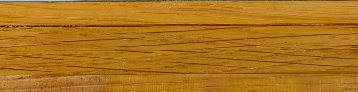

I subsequently mixed the 5 grams of CLOU powder stain with 250ml of hot water. The mix was instantaneous and no shaking or stirring whatsoever was required.
Mixed, I had my doubts as it looked very dark, almost black in the glass bottle. However, I poured a little on a nice soft cloth and wiped it onto my test piece of oak. The result?
And on the ship
However, I will share a secret with you. On the WB, I used Bluenose Pear's hull planking to plank my deck of the WB and I just left it completely natural with no finish whatsoever.
In my opinion this provided me with just the effect I was looking for. If I had to add a finish, I would choose a clear, matt poly finish. Try Googling Dulux's products in Canada for that.

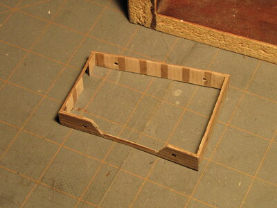

Hello Ship Mates, Well to take our minds off of the deck stain and the color of the lower hull the little fellows and I have turned our attention to the aft cabin. We have lined the chair rail so to speak in a stripe of cherry wood. We have assembled the upper half of the aft cabin and paneled it with strips of maple and cherry wood. We have also built and installed the set of stairs from the cabin deck to the aft deck. We have look at the cabin door frame and have decided that it is just two fragile to be able to install 2 sets of door hinges, this is where we are now.

I'm not exactly sure what you are doing on the shipyard, but your little fellows seem to have had some busy time on your Bluenose.
Nice progress!

Hello Johan, I guess you could say that we are trying to work around the deck stain and oil thing as we are still very much undecided on what way to go as yet. The upper aft housing we will varnish the inside and paint the outside white with the doors varnished also. Hope this helps with my mix up.
