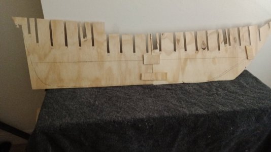

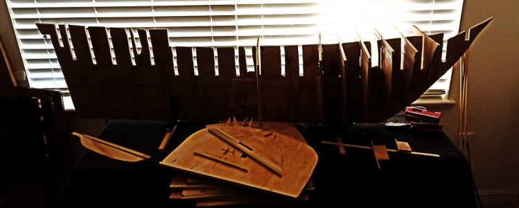

Today has been a wood cutting day. I cut out the keel, rudder and stern post. The media is 1/4" plywood, tomorrow I'm going to start cutting the Bulkheads.

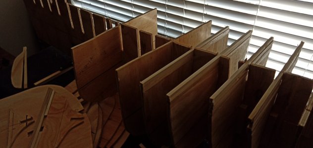

Yesterday (1/5/2025) and the day before, I cut bulkheads and sized them to the keel. This morning (1/6/2025) I cut dowel to size for all the Yards, to be shaped later. Today I will install some Bulkheads (having plans helps). I am attaching 2 pictures and an Excel spreadsheet that shows the Fore, Main and Mizzen dimensions I am using to fit my scale 1:50. Anybody any questions let me know.
