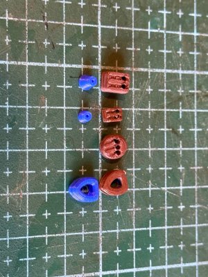

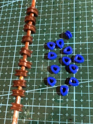

My son would give me his older/smaller resin printer, but there is so much mess with resin, smells, etc. but it's also temperature sensitive and needs to be indoors. And filament printers don't have resolution good enough for smaller ship parts.
Yeah, this is a common issue for the resin.
But, e.g. I use "eco" resin from Anycubic. Yes, I'm still do everything with gloves, but there almost no odors.
