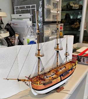

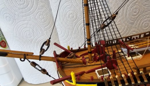

So I have completed the standing rigging - I used the plastic deadeyes for the shrouds (thread, from a jig in the kit) and they are indeed awful :-) I added blocks for the forestays and all things considered, it is not too bad as a first attempt.
But now I have to sort out the sails and running rigging and this is where I will need help please!

I think you are doing well. I tend to break down my projects into a series of subprojects and put them together much as you are doing. You may want to consider not doing sails at all. I think they tend to obscure the view of the rest of the ship, especially the rigging which you have taken so long to set up.
In addition to the wonderful build logs here, there are many you tube videos on all aspects of building and rigging, and making sails.
However this is your ship and you should do what you want.
Rob
Thanks Rob. I was thinking of following the suggestion in the kit..with the lower sails on the fore and main mast being furled, so there is a clear view of deck and at least some of the rigging
I like the idea of furled sails. If you do furl then it may be advisable not to use the whole sail so it will be as realistically "bulky" as the real thing when furled. you may want to experiment with different amount of a similar fabric to get an idea of whet it would look like.
This you tube video by Tom Lauria where he makes furled sails may be of some interest.
Rob
Thanks Rob, I also saw a video by Harry Houdini on making furled sails. I will try it first but as you say, with the material sails it may be a bit bulky. WIll have to give it a go!
