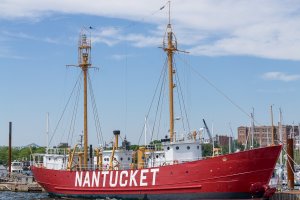

I have looked at pictures of the Nantucket LV-112 while she was in drydock in 2011. Her keel lines look similar to what is portrayed by Lindberg on my kit. I noticed that the model hull is missing a few holes just above the water line ( I presume these are drain holes for the bilge ). I will mark them on my hull to be drilled open.

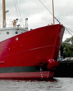

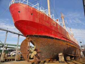

I found this photo of the Nantucket while she was in dry dock back in 2011. It clearly shows the black strip is running between two rub rails, where as the Lindberg hull only has one rub rail. I plan on using styrene strips to create my 'missing' rail. *** What appears to be the top rub rail on the kit should actually be a much thinner seam line that is running around the upper hull.

I also noticed that there are 7 openings that run just above the black strip that are not on the Lindberg hull. I'm not sure if these are water intake openings or drains for bilge. I plan on drilling open these holes and possibly using some styrene tube to create the port openings. Any ideas on this one?

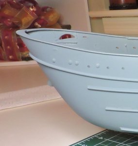

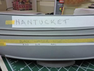

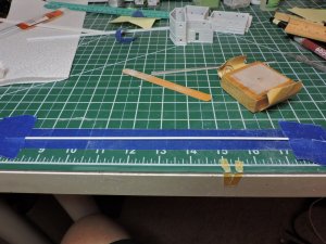

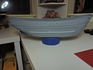

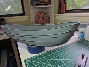

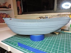

I worked on adding my missing rub rail to the ship's hull today. I taped down two strips of Evergreen round styrene and used a sanding block to flatten down about 1/3 of the round. I then used a file to round off the edges and cut them to size. I used a ruler to mark the placement of the rail to hull and then used a strip of tape along the line as a guide. CA glue was used to attach rail to hull. I then finished it off with gray primer.
I'm holding off on drilling any exit drain holes along waterline until I do more research on the hull for pre-1960. The color photo above shows 7 openings just above the boot stripe - but this photo is a fairly recent one. I feel that there must have been something like this used on the older hull to bring in/or drain water for the propulsion unit (which was a steam-powered system at that time).

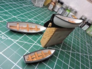

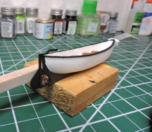

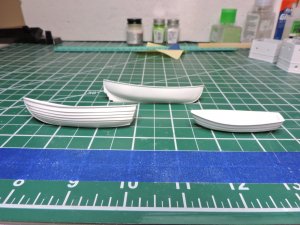

Primed my boats for the ship with white primer. I will need to go over them with some very fine sand paper before any paint is applied. I believe that by the 1950's, the USCG had standardized paint colors for their vessels. The very older version of this ship had the boats painted with red and black, but I think by the 50's they were painted white with black rails. I will look at more photos before final paint is added. My USCG Spar paint from White Ensign arrived today for the superstructure, masts, and vents as did my 360 degree LED 5mm lights from Superbrightleds for the beacon lights on the masts.

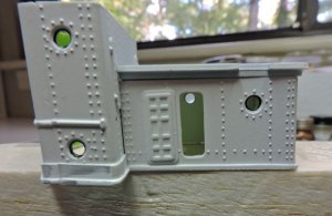

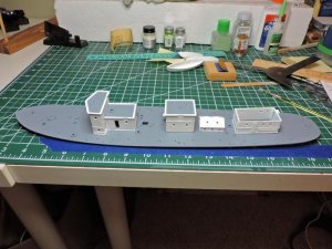

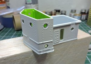

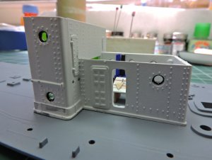

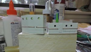

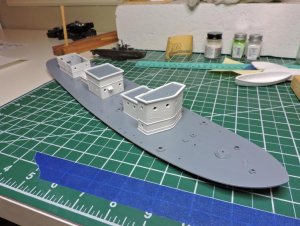

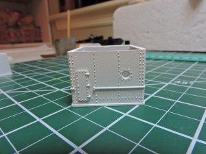

In between having a new roof installed on my house, I worked on putting the superstructures together. Almost every section of the walls had flashing, especially many of the portholes, that had to be filed off and sanded smooth. I used Tamiya liquid cement to bond the walls together and white glue to help fill in any visible seams. I then sanded smooth and sprayed everything with white primer. I had sprayed the top deck pieces for these structures with gray and then, after drying, I taped them off so I could spray the edging on these decks white. here they are place on deck for fitting only. (not glued)

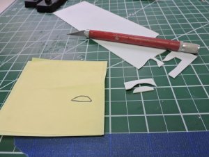

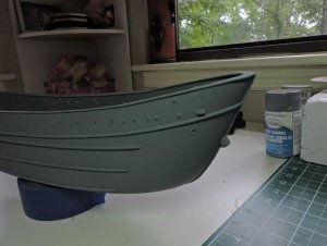

After looking at more pictures of the lightship, I wanted to correct the half-circle opening on the starboard bow that Lindberg molded to hold the auxiliary mushroom anchor to the hull. The actual hull shows that the auxiliary anchor was housed next to the main anchor at the bow of the ship. I first held a post-it to the inside of hull and traced the opening with a pencil. I then transferred it onto a sheet of styrene and cut the shape out with an X-acto knife. I used a sanding file to smooth the shape to fit the opening and then applied liquid cement, both on the inside and outside, to bond it to the hull. I used a little gray putty to fill in the seams and left overnight to dry. I then sanded it smooth and gave the hull a shot of gray primer.
0bcebb0e-238a-45b2-9306-6dbfb74368fe - Copy.jpg DSCN5606.JPG DSCN5631.JPG DSCN5627.JPG DSCN5628.JPG

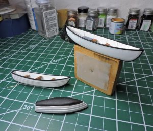

I was able to get a little more work done today and focused on the three small boats for the deck. I have settled with using white for the hulls, black for keel and rails and wood color for the interior seat. I need to spray them with Dullcoat and then add some rope coils.

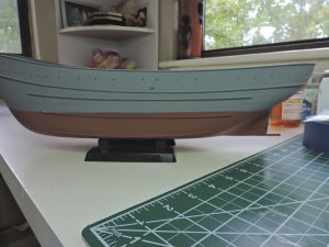

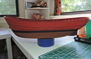

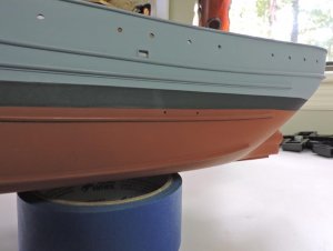

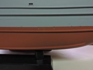

Set all of that aside and turned my attention to the ship's hull. I drilled two small holes into the hull's mid-ship just above the waterline to simulate the intake/discharge openings. I marked my waterline and masked off the upper portion of hull. I then sprayed the lower portion with an anti-fouling red oxide paint.
My lights from modeltrainstuff.com arrived one day early - Yeah !!! I'll try to post a picture tomorrow. So far so good and thanks to all of those who have offered suggestions and for following along.

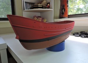

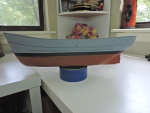

My morning project. I masked off the upper and lower portions of the hull and sprayed the boot stripe a flat black. I used Tamiya tape for curves along the edging and blue painters tape to mask off the larger areas. It came out pretty clean looking.
So this is what I have accomplished on Thursday and this morning. I was able to mask off and spray the upper section of hull a gloss red. After drying overnight, I sprayed the hull with Dullcoat to flatten any gloss shine.

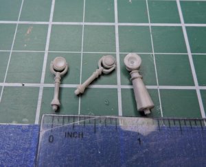

I filed off the flashing on the three searchlights that will go atop of the wheelhouse. The two smaller lights had mold indentations on both side of light and housing. I decided to drill out all three lights and I used a dab of Elmers to seal up the indentations on the housing side.
