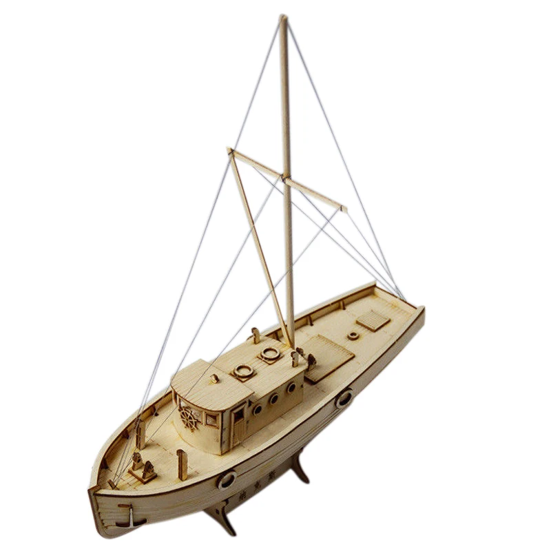

I've been a little stuck drawing up dimensioned plans for an overly ambitious scratchbuild- Silly me, I didn't think I'd need them. But I have also been itching to cut some wood. With Columbian Narco Subs in the news and one of those ten dollar Chinese laser cut fishing boat kits at hand I decided to build one. The kit is this one:
An astonishing bargain, and very nicely done. Since EVERYTHING is laser cut, the fittings are a little crude, but it would build into a nice fishing boat kit. It is also small, which made planking a little difficult. Since the real Narco Subs are lumpy fiberglass, that really won't matter. The hull went together in a day, with the stem sharpened up and the stern extended and rounded off. I'll post pictures when it starts to look interesting. If you are not familiar with these modern pirate ships, just google the term. Or the mother lode of information is at:

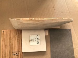

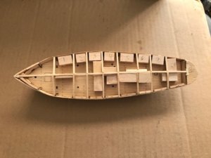

Here is what it looks like now under a coat of timber mate and supports for the upper deck and grossly over-engineered but quick to install mounting points for the deck hardware. I'll be using the paper backed veneer samples in the picture for the deck itself, and probably a layer of fine fabric over the entire thing to simulate the fiberglass.

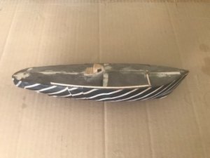

Some progress. The silk blouse material is now on the hull. I'll be sorry to cover up the pattern with paint, but as sharp as it looks it is not authentic... I covered the hull with a a few layers of shellac, and after that had dried I used a small clothes iron to attach the silk. Shellac melts at a low temperature, and the iron smoothed out most of the wrinkles in the fabric. Any stubborn folds were just slit open and ironed down again. Deck house and forward bilge piping are in place. Vents, hatches, exhaust, heat exchanger and little mysterious details can be added now.

It's still in progress! I wasn't happy with the paint and needed to find a way to show how low in the water she rides, but have found some solutions. Most wood glues melt and re-harden under heat, so it is a useful trick I learned from furniture refinishing. More news as it happens.
