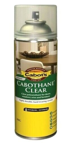

I have been lazy as a finisher to date sometimes using spirit stain for a colour when needed then coating with flat matt clear. It is a veryt durable and satisfactory finish but not inspiring...can someone recommend or at least tell me about tung oil or other rub-on timber finishes..? I want to upgrade my approach before I start on the Caldercraft Mary Rose later this year.
