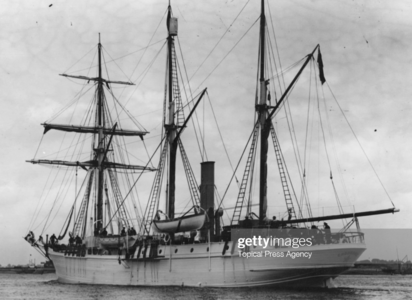

I have managed to find a couple of photos that appear to indicate there were navigation lights. One photo shows what looks like the port side light, other shows lanterns stowed on deck.
I agree, probably weren’t necessary once in the Antarctic, but she did have to travel across the Atlantic.
Thanks again. Also found several photos on Getty Images. Not sure if the 4th one is the Endurance. Mast structure is wrong as I’m pretty sure fore and main masts on Endurance 2 sections and not 3. Plus deck at helm looks much too high.
