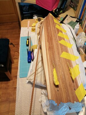

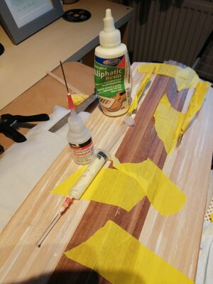

I have started the second layer of planking on my Amati Riva Aquarama. It is the first time that I have built a planked model but having looked at some previous methods I have adopted the following method which seems to be working well. Following Ken's advice from building a similar model I have purchased off Ebay some BLUNT needles and syringes which are quite cheap. The needles allow you to carefully control the amount of glue applied and allow you to get into the tight gaps. I first of all glue the bow end with CA glue for a length of about 2" and let the CA go off. Using the syringe filled with Aliphatic glue I then apply a thin bead of this glue for the rest of the length of the plank onto the hull. The needle lets you get glue very close to where the plank is already fixed with the CA glue. Because of the curvature of the hull I have found that the plank will make a tight fit the the preceding plank. I then press it down wiping excess glue away and apply wide masking tape to keep the plank firmly in place and give it time to set fairly hard. I didn't want to use nails as shown in the instructions because I didn't want holes showing when the planks are finally finished with varnish. As Ken suggested if the CA glue needle gets blocked just burn off the blockage with a lighter.
