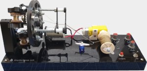

The new Domanoff "PL4-4 endless rope making machine with traverse" is looking very interesting.
Does somebody has already some experience with it?
What's new:
PL4-4: up to 4 strands with core.
PL4-3: up to 3 strands without core.
Fully redesigned and improved.
Built-in Smart Control Unit.
Out-of-box ready for using.
New traverse unit.
Endless means extra long result ropes.
Basic features
PL4-4 Endless rope making machine with traverse ("PL machine") is intended for making professional model ropes:
  • 2-, 3- or 4-stranded;
  • With/without the core;
  • Plain laid or cable laid;
  • Left or right lay.
Package Contents
  • PL4-4 automated machine with traverse*;
  • Built-in programmable Smart Control Unit**;
  • EU power supply***;
I do work with the small VR3.1 from domanov which works great. I changed it into a rope walk to produce the ropes horizontal to get lengths up to 4-5 mtrs.
In diameter I made already ropes cable laid up to 3,2 mm without any issues.
For this rope PL4 rope diameters are stated up to 2 mm, are bigger sizes possible on your machine Brian? Especially on the bigger scales these are needed.
