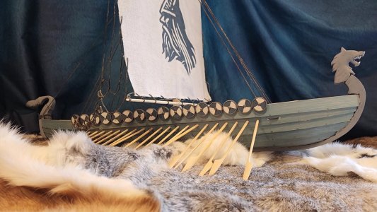

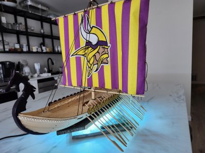

Hi everyone,
I've made a handful of scratch ships (roughly viking longship style) of my own design, going as far as cutting down the trees and collecting pine sap for pitch (didn't go as planned). I was unaware of the vibrant model ship community and your beautiful works of art. I just joined and it's been awe inspiring to see the research and discussions about details. My aim here is to improve in terms of design fidelity and building skills as well as enjoy the comradeship (pun intended). Here you can see my recent ships. I've already got a logbook full of refinements I want to make, but always feel free to offer constructive criticisms and advice! 20250311_174906_02.jpg20240825_161059.jpg

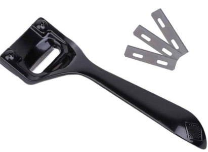

One part I still struggle with is making tight overlapping scarf joints in strakes (planks in a Viking ship) when the strakes are ~1/16" thick. Can anyone point me to a tool or part of the site that makes this quicker and/or easier? Right now is use a type of leather working tool (skiving tool) and a box cutter. See below for an example of the skiving tool. I was thinking a small powered saw with about a 15 degree jig to hold the strake getting scarfed but my current mini chop saw doesn't have the throat for this and the blade is of course circular. Apologies if i should post this somewhere else!

how about a shooting board? you can jig the angle and sand it down. nice part is the work is clamped down.
the other way is a scraper, or a plane, which ive used for many situations like yours. again using a shooting board to hold the work in place and have the angle set at the edge.
