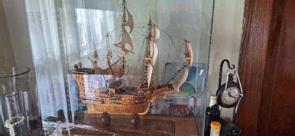

I am looking to repair / restore a model done be a family menber 70 + yrs ago. it was hand built as not a kit as he used burnt match sticks. generally I call it a Galleon which I no idea. I need to redo the sails and rigging so I am looking for "plans . and suggestions welcome I am attaching a pic of the vessel in it case

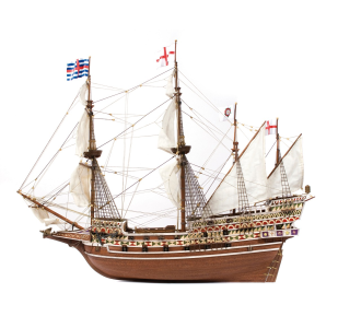

The ship appears to be an Elizabethan four masted galleon. The fourth mast was discontinued sometime before 1600. A four-masted galleon is that of HMS Revenge, Francis Drake's ship from the year 1577. You model may be based on it, or perhaps a Spanish galleon. Comparing the rigging of the Revenge to what you have will help you understand the rigging of this type of vessel. Attached below are the instructions for a basic model of the Revenge. The rigging instructions are easy to follow but will not instruct you as to what the lines do or their purpose. You can get that information from the book previously mentioned above. The offer an example of where lines could be belayed (tied off at the deck) and how they are run up into the masts and to the sails. If the model you are repairing has cut lines, they may help you determine what the line did and where it was routed.
