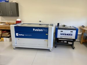

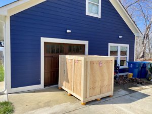

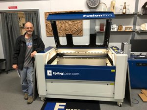

Many of you know the Admiral and I own a laser etching business separate from my model building hobby. Our business has been good the past year and allowed us to purchase a second laser. Here is the new Epilog Fusion Pro 48 we just ordered. It is a 48" x 36", 80 watt laser that includes state-of-the-art capabilities. On-board camera system, 15" z-axis, on-board compressor, positive pressure airflow, super fast, and it will cut through 1" of solid hardwood in a single pass. This thing is a beast.. It should arrive by early February.

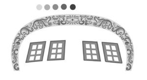

about carving with CNC this is a CAD file for the stern carvings at 1:48 scale first problem was the space between the scrolls averaged .015 to .007 that means you need a cutting bur the size of a pin. Anything that small would break from the pressure of the cutting action. (feed rate) and the speed of the tool. Bottom line the hobby grade tool we were using was not good enough and that was a $2,500.00 machine.
The next idea is the dots actually they were different colors. Each color was a depth set by the power of the laser beam setting. The idea here was to cut different levels. once again the beam was .012 on the big laser to big for tight areas. so we tried a 25watt laser with a .006 beam and that still burned the fine tips off the scrolls.
