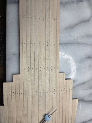

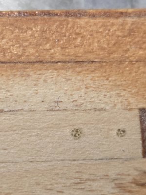

Slight disaster ....
I measured wrong while placing a part on the front decking, not a problem you think just pop it up remeasure and reglue, the problem is the parts in question have holes drilled right thru the deck
Crap
I could rearrange things on the deck but that little voice in my head would not be happy so I had to strip planks out of my deck, insert new planks and sand and finish again, this was made more difficult due the the very fragile railing that surrounded it
Like the shop teacher used to say "Measure twice, cut once." Model is coming along nicely. Fair winds!
You did the right thing, those things happen, but the good thing about wood is that it can be redone. It looks like it was a lot of work, but the result is very good.
