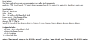

I looked at the Amazon listing and one thing stands out. Some mentions of an issue with the chuck or nosepiece running out of round. The drills are seen to exhibit a definite 'wobble'. Then I noticed the manufacturer (vendor, someone..??) put a disclaimer at the bottom of the description mentioning that it ran with a wobble.!!
If you have one, tell me what you think about this. I would guess that it is a real "thing" or the description would not have the mention added to the bottom..???
@Hobbit99 Whatever the tool, Dremel, Proxxon or others I think a 3 jaws chuck will never be as accurate as collets. Especially for small diameter drills
I think this is true if you are using the drill in a miniature drill press setup. Free hand, the human hand introduces enough "wobble" to negate the collet's advantage, if any.
