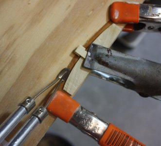

Totally agree that a well shaped plank is critical, especially edge bending which cannot be done with a plank bender. A simple set up and hot air gun is all you need for edge bending as in below. I used to use a soldering iron for the heat but find a hot air gun from the local hardware store is easier and works better. I did use her hair drier for a while but had to do it in the dark of night........ until I got caught.......
