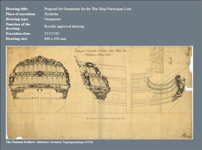

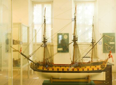

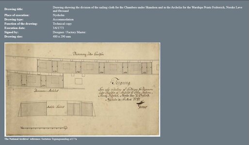

After spending a few days doing research, there is not a lot to be found on the Norske Love. I posted the info I found in my first post. If anyone has anything to share or add...feel free. I did find the following additional reference material:

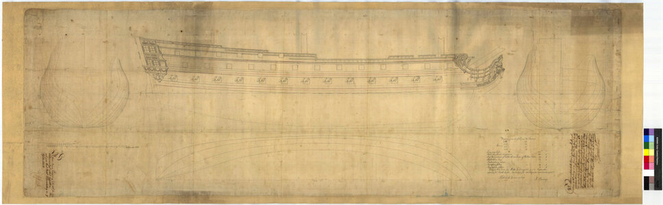

A ship image from the Copenhagen museum, which appears to be the same design ship...
A painting of a Danish-Norwegian ship...

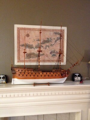

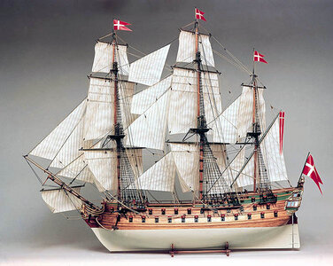

and of course the Billing boats demo model picture...

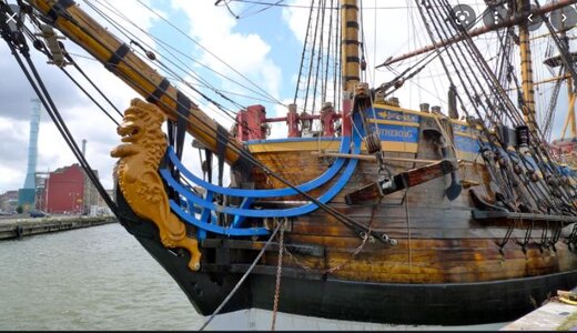

and finally a similar Swedish ship...

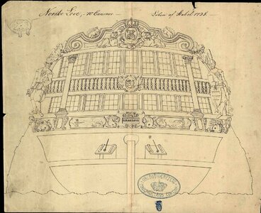

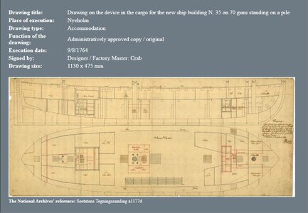

Dean, the stern drawing looks like 1735. I just noticed:eek:
Ok, that was one of the earlier versions then... actually the Norske Love built prior to the 1765 version the model is based on, but still a nice reference.
The one I have shown from the National Archives is from 1765, the one Billing Boats used for the model. However one could always chose to build the 1735 version. ;)

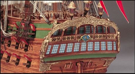

Pic of model stern...

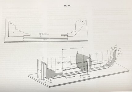

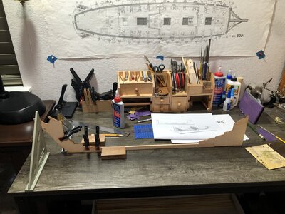

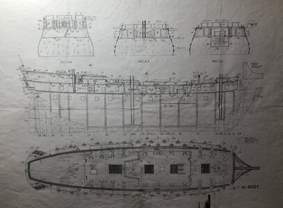

First step is the assembly of the keel. BB says this is an expert level kit, and therefore they assume you know a lot already about building a ship model, and there are very little verbal instructions, mainly some isometric views and full scale plans. It seemed intuitive enough for me to build it as a first ship, but now after some other kits, I realize it might not be a good first kit for some, that is because you will rely on the full scale plans more than anything else! So it leans more towards a scratch build, relying on plans mostly, with some precut parts to ensure accuracy.
They give you lazer cut ends of the keel. You are to cut a board to length and join them. Then there are no slots to locate the frames. You will locate them with other pieces of wood that act like spacers, and are glued on top of the keel (board) that joins the stern and bow pieces.
Here is the instructions…
This is the full scale plans…

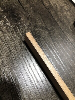

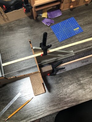

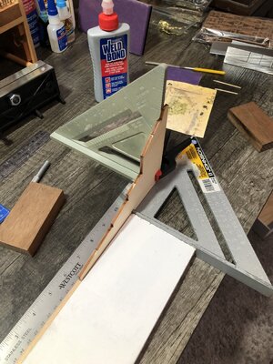

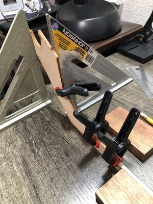

Funny thing is, the wood to join the stern and bow is 5mm thick, however the lazer cut plywood is 4mm. This makes life more difficult! I don’t want to get out my table saw and try to rip 1mm off the edge of the 5mm keel board. So I marked the 4mm in the center of it to locate each end. To make matters worse, the center board is taller than the notch in the stern and bow plywood. The location of each frame on the upper portion of the keel, in relation to the board and end pieces, is more important than the bottom. So don’t be tempted to make the notch taller in the end pieces, as this would make those frames lower than they should be! Later it looks like I get to sand or plane the bottom of the keel flush, and the thickness will be adjusted as well...sigh!
Here are some pics of me gluing and ensuring everything is square despite the aforementioned differences!
50B8D450-BE91-4549-AC75-CE50AC915928.jpegF2DEBCB1-4BF7-45AE-B1AB-0882A1C76A5F.jpeg8BA2A0E1-AC58-4E51-8169-AB57E3ACB011.jpeg473CF3C0-80D4-46EE-B8AD-36EE94D14B54.jpeg
So this initial step, that seems like it should be quick and easy, took more time and effort to ensure I get a good start, with everything square, centered and plumb. Next will be installing the frames and adding the spacer boards to locate them on the keel.

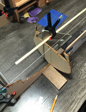

Installing the first frame. You can use a square to keep it perpendicular to the keel, and a square to keep it perpendicular to the table or bottom of the keel. But port to starboard you can’t use a square, so I used the typical method of a string on the center of the keel bow to stern. Then just make a mark in the top center of the frame to align with.
Only 13 more frames to go… :p
