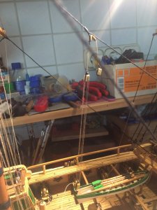

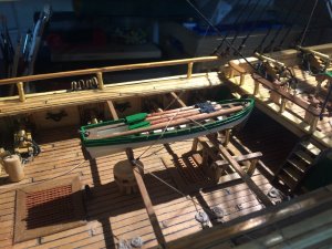

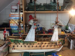

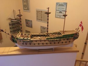

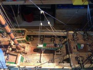

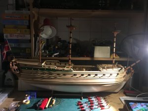

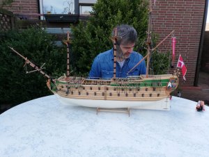

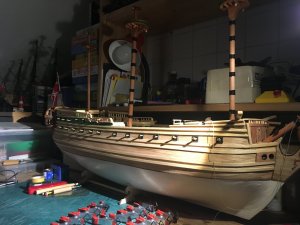

Hello,

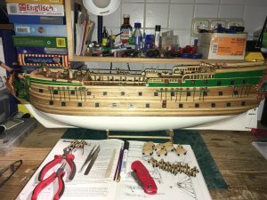

I would like to show my current build, the Norske Love by billing boats. Unfortunately there are no pictures taken from the beginning, so I only can show some pics taken in last six months. I leave them without a comment, just to show, how far the build is. The next steps of the rigging and completing I will show from time to time.
The last picture was taken today and shows the annoying process of rigging.
Greetings
Michael

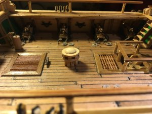

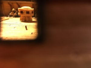

A little progress.
I had already written that I miss for example a dinghy. I quickly found a matching boat in my crate and repainted it. So it looks like now, what I do not like in the photos is the pump, which I will revise again.
To be continued.
Greetings
Michael
