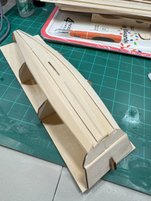

N-Pram-1 is the planking. This is about halfway complete. I took my time use Gorilla Wood Glue. The set time is about 10-20min and allows me to continue. a bit of a faster pace.
I used a clothes steamer to bend the planks in place. I do this by clamping the planks in place gently and steaming them. They quickly dry and set within minutes as opposed to soaking the planks. Just make sure you've waited for the last planks glue has set.
I repeated this for the rest of the planks. I found in the end though I had to use CA glue on the ends but that is OK.

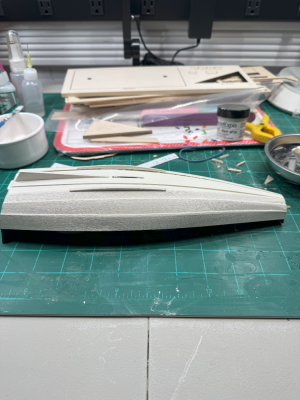

The 2nd photo is the completed hull with running boards and stabilizer painted off-white. I really enjoyed how it looked after taking my time sanding and smoothing.

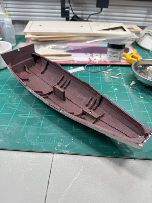

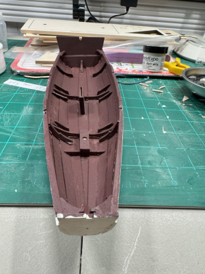

The final photo's are the inside. Now here I had a lot of problems figuring out the different pieces and looking hard at different photos. Had no idea what the parts are One of the things I really like about modeling is learning about cars, planes ship etc. But these kits from Shipways make it difficult to learn from.
As you can see in these last two photos some of the parts didn't quite fit snug and I was at a loss as to how to correct them.

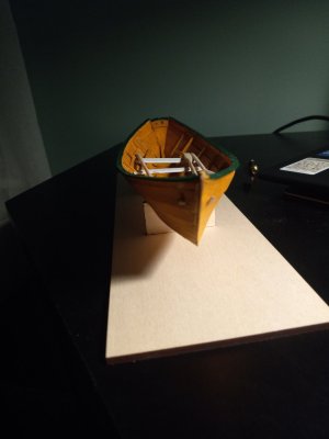

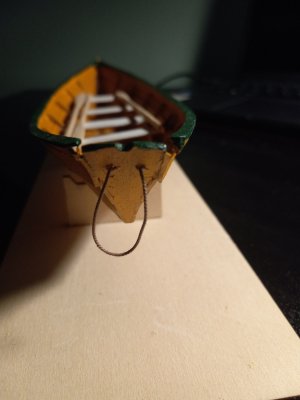

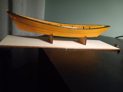

Working with wood is like learning to walk, the first few steps may be stumbles. You're doing well. I found the MidWest directions could be a little more precise, but like their three step for beginners kit. I had trouble building the Dory too, and am doing the Norwegian pram now. Like learning to walk, this kit is designed to teach how to bend planks.

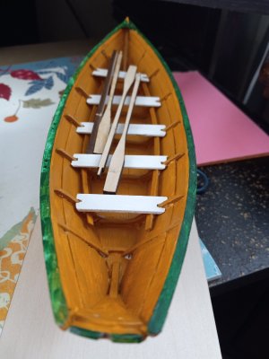

I lost an oar, an experienced modeler will see many mistakes, but this is on my desk now, because mistakes or not, it was relaxing and fun to do while at times frustrating, and I am proud of it. You're doing fine, don't stop...as the builder advances, the more complex models will become more difficult, but those are also learning experiences.
