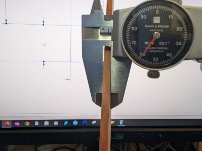

Not to brag about my Byrnes Model Machines Thickness Sander, but I'm kind of a fan.

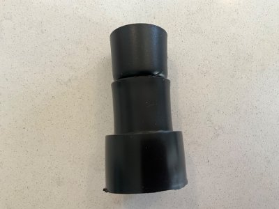

The thickness sander from Jim Byrnes is top shelf. I did learn quickly to get an adapter for the shop vacuum though as the sander produces a very fine sawdust that will coat everything in a room in a few minutes of sanding.
Yeah, that's one of the first things I did when I got it, good thing it fits the saw, too.
What was source for vacuum adapter, in past few times I have used mine, I taped the hose to top of unit, held for the short time I needed it but not much longer.
Amazing! What type of wood is that?

If you are looking for an adapter to fit whatever you have for a vacuum, to burnes’ machines, make a visit to your building supply store. I found pvc pipe and plumbing elbows did the trick.
Along with the pluming parts David mentions look for rubber flexible connectors. These slip over pipe and are secured with hose clamps. The dust collection industry does not seem to believe in standardization. Be prepared to assemble your system on the floor of the store.
