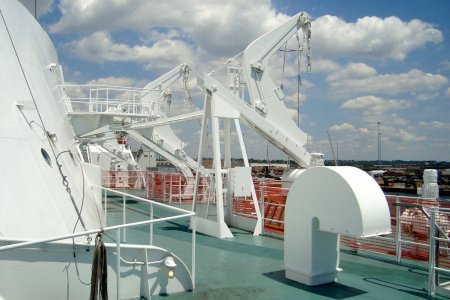

I am a former engineer on the NS Savannah and am planning a scratch build. I was able to find templates for the bulkheads and keel. What I am looking for is deck fittings, cranes and other details and measurements to scale down.
have fun going thru these.
NS Savannah Booklet of General Plans (196X) https://archive.org/details/ma55bogp196x
NS Savannah Capacity Plan (1966) https://archive.org/details/ma55cp1966/page/n1/mode/2up
NS Savannah General Arrangement (2007) https://archive.org/details/ma55haer2007/mode/2up
NS Savannah General Arrangement (2019) https://archive.org/details/ma55ga2019
NS Savannah General Arrangement Details (2022) https://archive.org/details/ma55gad2022
NS Savannah Booklet of General Plans (2023) https://archive.org/details/ma55bogp2023

Thanks David for the info. Although I was able to locate most of those drawings there are a few that will definitely be helpful
This is the problem with scale cargo ships, a good way is to compares the plan with good photos of the deck fittings. I have hundreds of Savannah photos if you need something specific let me know.
