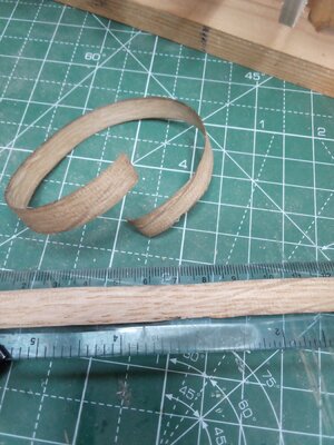

Out of interest I tried planing the edge of a piece of oak with the cut set coarse. The shavings are shown in the following picture.
They are about 0.5mm thick but I could probably achieve the 0.6mm of some (mahogany) strips in my kit.
They are a bit curly but I assume they would stay flat if glued, for example, to a deck. It would make a change to straighten strips

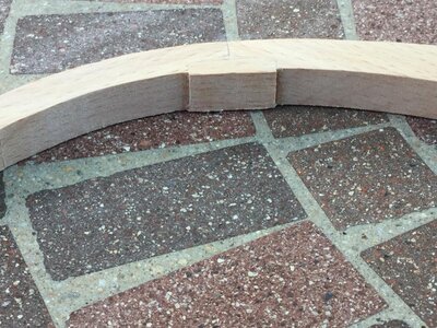

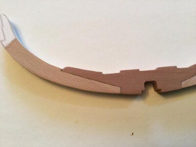

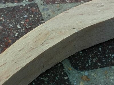

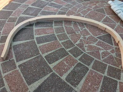

The best wood to simulate oak in a model is beech. It is straight grained with tight pores and looks like oak. I wouldn't use it for anything smaller that 1:48 scale. Below is what it looks like. The last photo has swiss pear in it also. The scale is 1:32 for all.
Red oak here in Minnesota is very common, the most common hardwood, and used for virtually everything. There are at least 70 red oak trees in my own yard, mixed with pines and popple (poplar) trees. Red oak is so porous that it looks like the dark grained areas are hollow soda straws. Thanks DocBlake for the tip on using beech. The piece of bending beech used on the supports for the beaks head on Corel's La Couronne does indeed look like oak at the ship's scale when stained and the grain is tight. I want to buy more beech and use it as keel lumber, but haven't had time to look for a supplier that's close to me. Anyone have suggestions where to find some beech timbers?

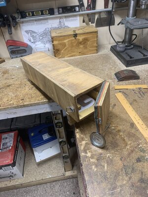

I get my wood at house construction sites. there is an abundant amount of maple, oak, sherry maple poplar that is used in finishing house. also go to wood working shops all have a scrap bin of drops. in fact I was able to procure 20 19 x 48 x 3/8 sanded plywood for a casket manufacture here in Connecticut. I save a lot of money doing this and seeing i have a planer i can mill to the thicknesses i need.here is a picture of my steam box made from casket drops
