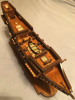

It's obvious that it was made with great care. It's very impressive.
Thank you! I am pretty detailed and matriculate in anything I do. You ought to see some of my custom Star Wars Lightsabers that I construct for CosPlay/ComicCon enthusiasts. Very detailed to movie accuracy.

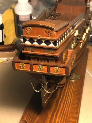

I am guessing this is something the kit maker came up with but FWIW chain was not used for emergency steering on the rudder until the 19th century.
Weren't the chains fitted that way to prevent the loss of the rudder if it came detached avoiding it's loss.
Thanks Mick, :)
Yes the rudder pendants, be they rope or chain, had two purposes.
1. If the tiller or its connecting mechanism broke, the pendants could be rigged to provide limited steering
2. Heavy seas could sometimes lift the rudder right off its gudgeons. The pendants tethered the rudder to the stern, preventing it from being lost.
I noticed one model of an 18th century ship at Preble Hall with a chain rudder pendant so did a little more research and found a comment that while rope was the common material up until about 1811 for English warships, chain was sometimes used in the second half of the 18th century if on wartime patrol. A caveat, the chain on the model at Preble Hall may or may not be original.
All your explanations make sense. I was going to guess they were for limiting the rudders throw so it won't break off at the stern during rough seas if the steering mechanism fails of can't be controlled.

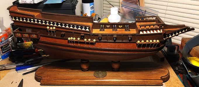

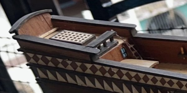

Thanks HughLo. I also was after the different stain tones. Just simple gel stains (oak, maple & walnut) thinned out with distilled water. First coat absorbs into the wood, followed by two more coats. Then a universal acrylic sealer.

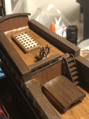

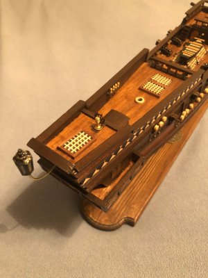

Yes, I added the ships wheel & pedestal. That rearmost elevated deck had nothing on it from the kit. It looked quite bare compared to the other decks.
So, I thought ahead and bought the pieces from Cornwall in the UK before I even started the kit. I needed a new wheel anyway for my Blue Nose that was cheap plastic that disintegrated a while ago. The Cornwall offerings are brass and cast metal. Very nice quality.
Carved a strip of walnut to a wedge so the pedestal and wheel were level, since that deck was at an angle downwards. I also made a narrow grating to fill in the area between the wheel and the outmost stern where the lamp sticks out.
I think it looks pretty good. Can't always follow the kit 100%. Gotta use a little creativity. What I might also do is make a narrow ladder/step from the deck below to that upper deck. How else would a helmsman get up there to steer?

On the Buccaneer (which I rechristened Molino), I too added a grate, a set of stairs, and put some railings up like at the edges of the other decks. I also added a “rope” hand rail on the steps.
I’ll be honest, I was like your son, but looked it up before saying anything.
HughLo,
That looks really nice with the rail matching the rails on the other decks. I should have thought of that but did the 2mmx2mm strip on the deck edge as in the ship's plans. Then added the grating like you did, but put on the ships wheel.
I will add a ladder like you did and possibly add a rail that will be much narrower than the 2mmx4mm. Probably 1mmx2mm.
I'll take before and after pics. Can't have enough stuff on a pirate ships deck.

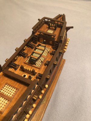

Fabricated stairs and rail in front of helm. Went narrow and lower on the railing as not to block the helm or make it look small. Turned out pretty good thanks to the tip from HughLo.

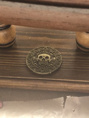

Before and after pics, plus the POTC medallion mounted on the base between the stands. Yep, free to do whatever on this mythical ship.
