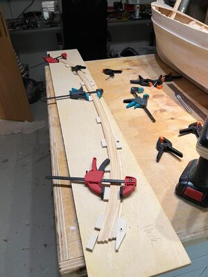

What method have others tried to fasten the bulwards . Is it easiest wet or dry/?

I fitted the bulwarks dry and it was a pain. I don’t think I’ll try it that way again. You can see some photos in my Build Log (Link). @ Fletch Dog suggested using a scrap board and placing nails to mimic the curve of the bow and molding the bulwarks to this form prior to placing them on the hull. For that method I would heat the bulwarks with a hair drier or heat gun and slowly press them into the mold. If you haven’t planked them yet you could also wet them prior to forming. Others may have different ideas…

I first shaped the wet bulwarks to the curve of the deck and let them dry up before gluing and nailing them. I too was a little scared by the process because there's not much material to attach the bulwarks to, but to me it actually turned out to be more straightforward than expected :)

Thanks El capi. I've already wrecked a pair and it took forever to get replacements so I'm a little gun shy. I saw the jig you referred to with the nails and it looks logical. I'll give it a try
