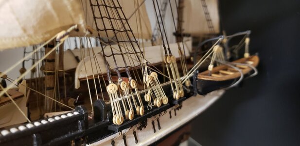

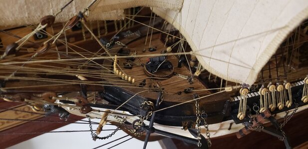

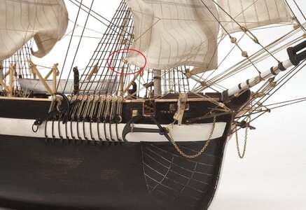

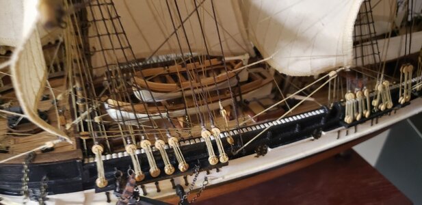

Hi Michael
These are the lowest sails of both masts. Lower corners don't connected directly to the mast or anywhere of the ship. They are controlled by the ropes which are passing througt the blocks JT71/JT76 and JT72/JT77. This is not HMS Beagle but i put this picture as an example. I hope this helps.
