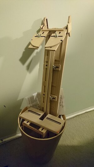

Bowed, warped, twisted, flimsy, unstable and the screws cannot be tightened enough, structural slipping, so many variables that nothing can or will remain square on just about every plane on any surface. Oh dear :(
....I've often wondered about those things. Heard years ago they were garbage. Kind of like the "jig for shrouds".
Yes I agree, I think the concept is reasonable, but should be simplified and redesigned using decent, solid, and larger timber all around. Screw heads squared an inset into timber so the wingnuts can be tightened for example.
And I thought I was the only one that had problems wi this jig. You have inspired me to create some space in my closet that had heretofore held my fair-a-frame. Thank you for the courage to recognize that not everything in life makes one’s life easier!
Glad to be of service. The truth hurts but we are better off with it than without it. The truth I mean.
I have an amended design of this jig in mind with different materials etc, unsure whether to spend the time on it though, I have a number of other projects I would rather continue on with. Hmmmm.

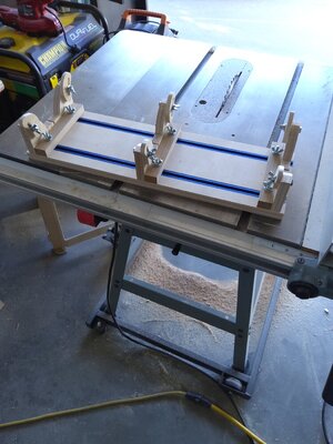

Done, actually I just use a plywood board and some shelf support brackets, works perfect.
That’s nice, Phil. I think I’m going to need to copy your design (Plagiarism is the sincerest form of flattery).
