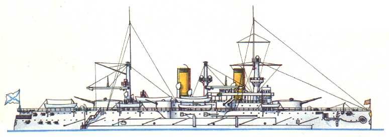

I(mperial R(ussian) N(nay) SEVASTOPOL the ship easy to distinuish from her two sisters as her funnels are shorter than the crane pole inmid.

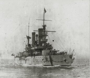

Her her sister IRN POLTAVA hhows the well rounded hull (and the second source to distinuishing the windows' number in the wheelhouse). She is a typical pre-dreadnought (Loa 115ms/Lcwl:112,47ms/Displ.:11.354ts) with her twin pair of 305mms on both ends and a huge numbers of 152mm artillery (boardside two in twin turrets two in single cassematte mounting) and six 457mm Tts (4 above/2 below CWL) and a mixture of a dozen 3pdr/47mm and 28 1pdr/37mm QFguns
Certainly in her pacific colour sheme a lot of details will be easier to be seen but the kit is printed in her Baltic/Black Sea blueblack hull delivery.

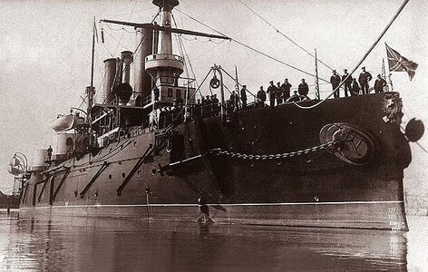

Of intrest may be the Admirality achor (here on IRN POLTAVA with the longer than pole funnels and a four windows wheelhouse's front) in his tremendouse size and
this astonishing edge simply cut into/out-off the hull's side. This pictures shows also the 47mm Hotchkiss guns in question in hull were QF guns - not revolver cannons (may be in the crow nests?) as I hoped.

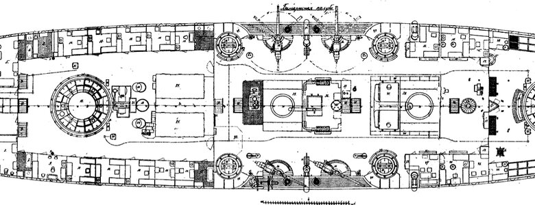

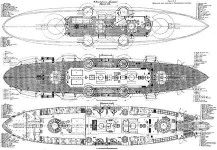

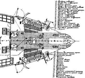

Here some of the dockyard's plans that are surviving giving some ideas about what is in the hull that may bee viewable through the bulleyes - in particular:
The officiers' accomodation aside the center cassematte's 152mm single guns.

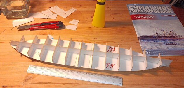

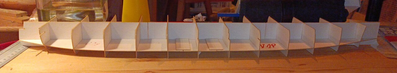

So yesterday night I started to complete the LC-skeletton so far,

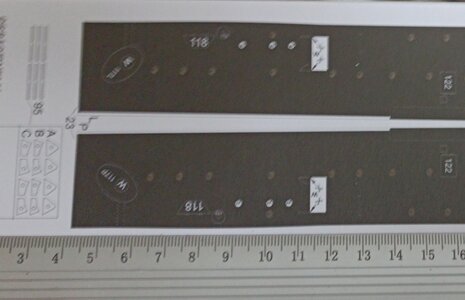

cutting down the UWS to 10mms below CWL to get a bit of a hull's shape in the clear resin (on my monitor in the background is the building of IRN ADMIRAL NAKHIMOW 1888 by a colleauge giving a lot of very helpful hints) that may be coloured greenly/brownish a bit. Due to this one "anchor pocket" will be visible completly emptied - and I do think about placing a 1/200 figure in there as a Mr. McScale.
A some idea about the shape of the hull in length and the bulkhead's - all of them survived the leckage in my celler not so I had to rebuy them again.

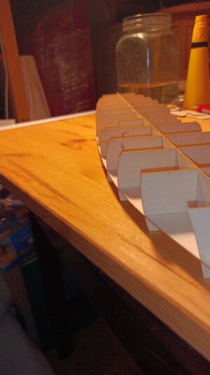

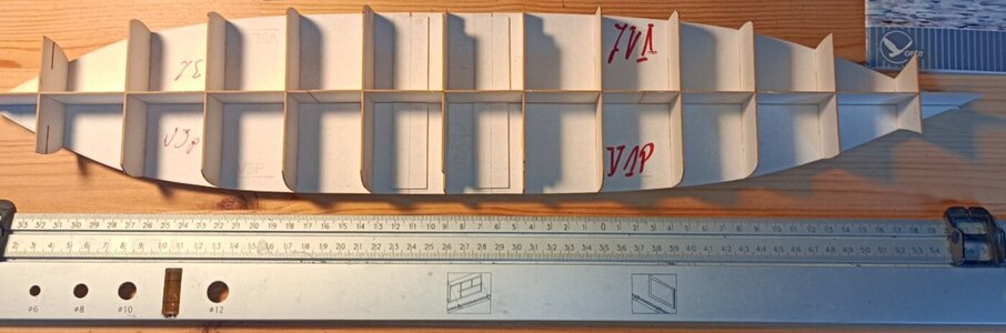

Here the hull's outline with some possibility to insert some further details. Thebhorizontal LC board ist the "real" CWL so I do geht some more hull under water to show.
So this was my yesterday's result and I stopped after sticking them into each other as a very first fitting test.
So for this afternoon my idea is to cut out/sand the bulkhead's beavel and starting to fill the more delicate sections with some balsawood (grain horizontally!) to get some good surface to deal with - in particular under the CWL. As the detailling inboard is still in discussion in my mind to add some more intrest into the kit.
Is there anybody with an idea WHO supplies some PE bulkheads of 1.5mm diameter in a good quality?
This the kit's skeletteton do look like...
...and it is 562,5mm in length - due to this my diorama should be 600 mm × 120(+golden rule addit) mm
