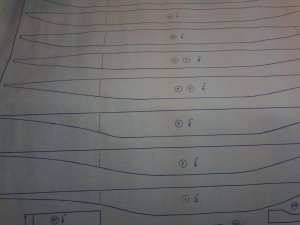

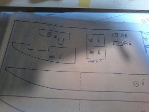

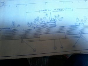

Hi every one, NEED HELP WITH A PROJECT THAT I NAM STARTING IN OCTOBER FOR A CHRISTMAS PRESENT for my oldest son, but want to start getting materials now, it is a BREAD AND BUTTER BUILD OF A WWII LIBERTY SHIP and I need to select the wood that I will be using for color, I am posting pictures of the plans and a photo ( IT IS FROM A KIT THAT I GOT on ebay all in BALSA witch I am dicarding completly) I need sugestions not only for color but the THICKNESS OF THE LAYERS, the plans call for 1/8 INCH MATERIAL, but i am worried about the appearance of to many glue lines and was thinking about using 1/4 INCH MATERIAL, need help on this PLEASE20190708_041053[5863].jpg20190708_041259[5862].jpg20190708_041658[5861].jpg20190708_041819[5860].jpg20190708_042102[5859].jpg20190708_041658[5861].jpg

The glue lines will not matter if it is going to be painted. Just use wood filler to get a smooth surface once assembled then use a primer, then the finishing paint.

THANKS DOC, I am stumped on that one too, what do you think about the GLUE LINES witch thickness to use 1/8 inch as the plans call for or 1/4 inch to have less glue lines. THANKS Don
Hi Don,
A dark grey translucent stain on a light-colored wood (basswood) would probably look okay for the superstructure.

Hi Doc and Mike, THANKS THIS IS THE WAY I WILL GO as then templates are set for 1/8 inch pieces I think if i went with 1/4 inch thickness material using a pattern rubber cemented top and bottom, the bottom representing the lower lift and the top representing the upper lift, do you think that would work also my thoughts for finishing the wood was to tung oil and then a coat of poly, how would you finish the lifts that have the gray stain i appreciate the help greatly. THANKS Don
I do not see much advantage to trying to use natural colored wood here. for one thing there is no gray blue wood that I know of so all the upper works will have to be painted or stained. you can use the ebonizing technique that will give you a blue gray color, but if you go that route might as well just use a stain.
for the bottom bloodwood had the best red color but the wood is very hard and difficult to work with. cherry in time will turn brown and loose the redness. There is a red Mahogany but most on the market is a pale color and not even close to the color red you see in the picture.
looking at the model n your painting with wood topic the model looks really nice and the use of different wood makes it even better. but like I said with this project with just gray and red i don't think a natural wood color approach will work as well as it did in the other project
