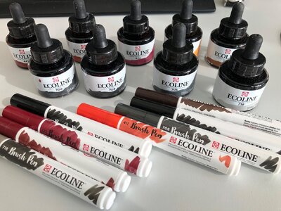

I do not know, if these paints are available in Australia, I can fully recommend the watercolour paints from Ecoline
Also @Maarten used them on his Bluenose, I am using them since two or three models, and I guess also several other members here

Thanks Uwek, I found ecoline in a store here, I’ll check them out
