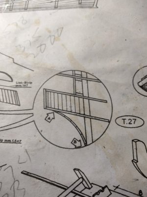

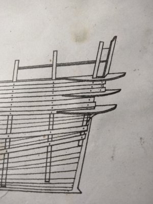

I was also looking for the plans. The copy I got with the kit are poorly reproduced copies that don't provide consistent information. For example detail T27 shows the stern platform at quite and angle.
Detail T21 shows them flat.

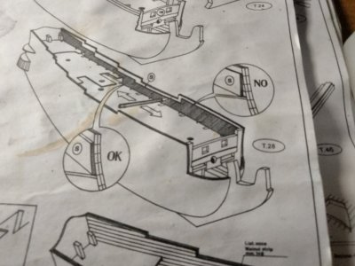

17632584719137309196787252731039.jpgFigure T 28 Shows template S. It is supposed to help in marking the heights of the hull at the sides. This part is non existent in our kit.17632586311417636241967734183554.jpg
