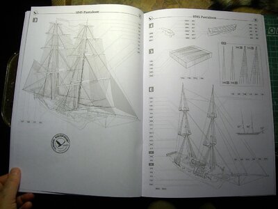

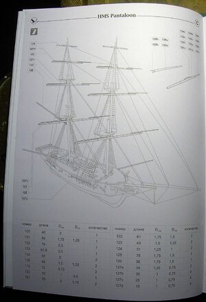

The plan's booklet gives us a plenty of fine detailling and helpfull scetches to the rigg:
I am absolutly unshure how to build her in full canvas or with blank masts:

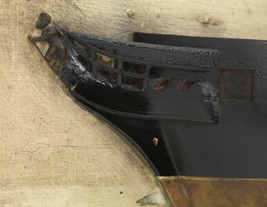

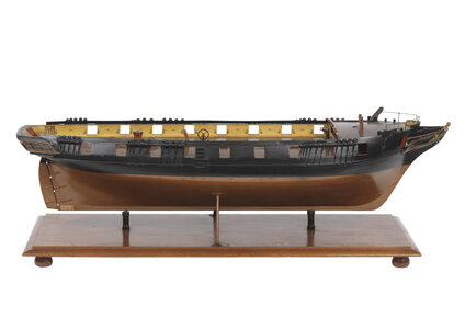

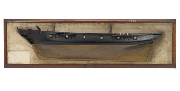

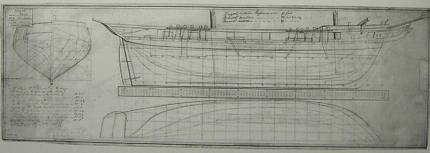

We do have got the halfmodel of her hull in the NMM with the ordonance in ivory with her complete black hull as driven at the African west-coast during the fight against slavers*:
As the kit comes with a print of the hull with her early colouring I decided to take her in this manner as I think a

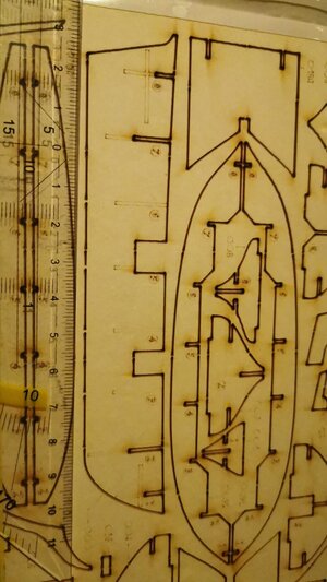

So I have ordered the
laser-cut bulkhead set and other helpfull items. The space between the bulkheads will be filled with balsa wood - and the gunports in the bulkwark are slightly opened for the hot summer of 1840. Soaking the bulkwalk with superglue should make it stiff - so the guunports could be openend. I like to try to open them - as the staircases (the cut outs are given in the longitudinal frame/center board) to give some more eyecatchers on this small model with its tiny (some160mm) long deck.

The admirality drawing ZAZ5113 gives us a fine lined yacht for high speed - ideal for a fast messenger in Royal duty or a hunter of fast slavers. Important to me is the absence of a steering wheel. Alsoo the rigg is quite simple as it is a brigg rigg and I am planing to use Evergreen piping material for
the masts and yards in ZAZ 5115

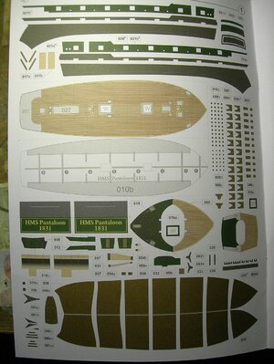

In the cardboard the inside bulkwalks are really printed green (and the ugly bronze-brown is viewable)...
Parts 20b/20a 21b/21a
but the contemporary HMS ROVER is painted in buff...
with red transom gunport lids...
... do I have to change the colour???:rolleyes:

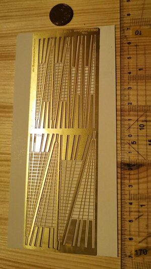

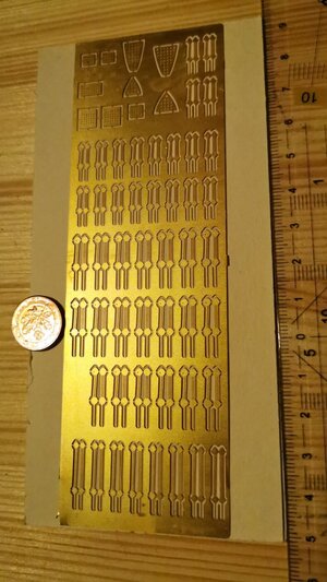

Hello my last patch of additive parts came by pacel today - so on the weekend I cannstart with the build in my axillary ship yard.

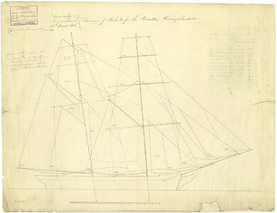

So as a first step I will have to photocopy the plan set to get spare parts for safty. Also I will try out to enlarge the kit by 312% (in two steps by using 156% =1/128) to come up to 1/64... to go towards more a scratch than an kit bashing I think.
As I figured out today there is NO masts and yards set coming with the additive PE-parts - because I couldn't order any, as ther isn't any...
So I do need to work with a print out of the
sails plan and reduce it to 1/200 scale.
I have been told to decide the very finished configuration of the model as my goal. And was advised not to change it in any way. So I think I will build her under full sail with yards in 45°. I want to add her in a display stand - using two chess figures with a cleft head and a nail in it for fixing the hull over a marhaghonian wood board.

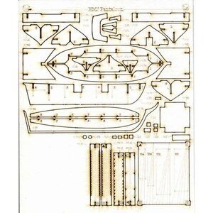

So let's start with the kit review and it's additives to give you some idea what I am talking about a 150mm long hulled card board kit.
Yours Chris
(Pictures do follow tonight.)

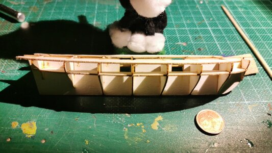

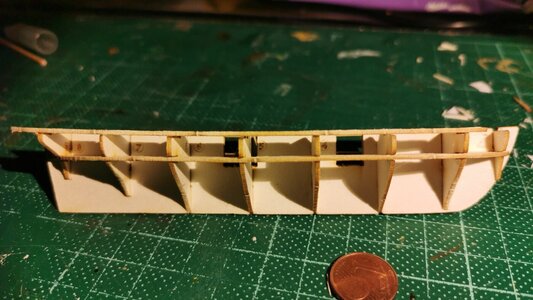

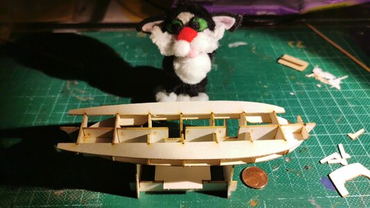

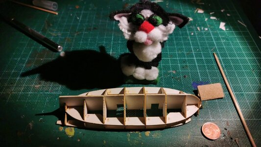

Here the first step on the kit, the
center board only has grooves from above. When a groove is to be driven from below you have to cut them by your own.
