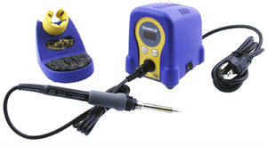

I begin my Belem model from Artesania Latina. I have PE in this kit and it is the first time I will work with this kind of material. Wich soldering station tool can be used mostly exclusively for the Photo etch parts ? Is 60-80 buck at amazon deliver good material or should look mainly to more expensive kit ?

I hesitate now between
Weller WLC100CUL 40-Watt Soldering Station and the 70 Watt
Weller WE 1010NA Soldering Station
Is WE 1010NA overkill ?

Hi Michel,
Which one you get depends on what you think you'll be soldering, if you are only ever going to solder PE then you might get away with the 40 watt one if you then start to solder heavier things you will need more power.
In my opinion I would go for the 70 watt unit more power is better for this sort of soldering.

Hi Michel,
I don't know the HAKKO brand, just red a review that said the temp adjustment is not very friendly on this model. Weller have a good reputation though at that price point I wonder where it is made.
I have a reasonably cheap soldering station that works fine, just read some reviews before committing, other wise Weller have the name as far as I am concerned. To summarize I would look at lower price units that have a good review if you don't want to do that stick with Weller but still read a review on that particular model.

OK thanks,
I read a lot of stuff, but there is always some guys that said somethings negative on some of the amazon cheapest stuff.
