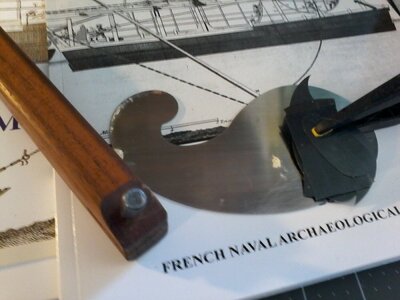

A COUPLE OF THINGS, TO WHISKERS POINT I TO USE BOTH METHODS TO FILL GAPS AND I FIND USING THE GLUE FIRST AND THEN SANDING TO BE BETTER ALSO ON DOUBLE PLANKING IT IS NOT MY FAVORITE WORKING WITH VENEER IS PRETTY DIFICULT UNLESS IT IS THE NEWER TYPE KITS WITH PRE SPILING AFTER MANY DISASTERS TRYING TO SAND OUT THE SUPPLED PLANKS SANDING THROUGH IN SOME CASES WHAT I DO IS USE A THICKER MATERIAL LEAVING ENOUGH TO SAND IT DOWN SMOOTH I DO NOT LIKE MOST OF KIT SUPPLIED WOOD ANYWAY AND I DO HAVE GOOD AMOUNT OF WOOD ON HAND ALSO I FOUND SOME MINI SCRAPERS ON AMAZON THAT ONCE BURNISHED WORKS GREAT ON HULLS JUST ME. GOD BLESS STAY SAFE ALL DON
NO NOT PUTTY KNIVES ACTUAL MINI SCRAPERS WILL SHOW A PICTURE OF THEM IN COMPARISON TO MY REGULAR SCRAPERS BUT IT HAS TO BE TOMORROW MORNING, ALSO A NEW BURNISHER I GOT FROM STEW MAC AS THEY HAVE TO BE BURNISHED AS THEY COME DULL. GOD BLESS STAY SAFE ALL DON
SORRY FOR THE DELAY PROBLEMS WITH BOT LAP TOP AND TABLET OK NOW HERE ARE THE PICTURES OF THE MINI SCRAPERS COMPARED WITH MY REGULAR ONES AND THE STW MACK BURNISHER A GREAT BURNISHER IT IS, HOPE THIS HELPS. GOD BLESS STAY SAFE ALL DON
Ah ha. I know exactly what you are talking about now. I have a few of those in my shop for woodworking. Thanks. Computers are great, when they work.

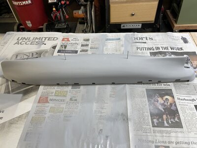

I want to thank everyone for all the help in getting the hull in shape. I completed the planking with reasonable success. Some slight imperfections but you need to look closely to spot them, I think (smile). Next the gunport cleanup.
