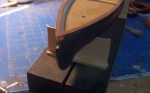

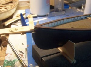

I have this kit, both the solid wood hull version and the one with a cast resin hull. In both cases I marked the bow with a pencil and used a dremel tool to cut the opening to fit the bowsprit through. If you are careful it is easy enough and can also be accomplished with a razor saw. Neither of my models is finished so I will kake some shots of the bow to show what I did, I also have Chuck Passaro's practicum and have found it very useful. Unfortunately Chuck and I are no longer on speaking terms which is too bad as I admire his work.
