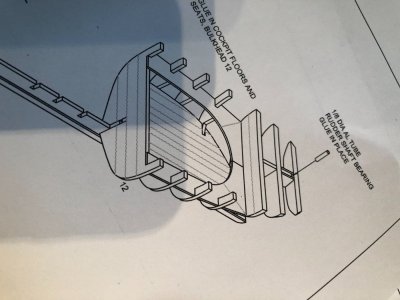

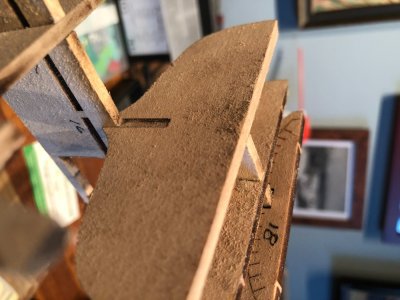

My current build is the Model Ship Ways Picket boat. I'm about to install the bulkheads, but ran into a problem. The aft bulkhead, #18, is supposed to be flush with the other bulkheads, but when seated on the keel it is about 1/4" above the other bulkhead and I don't see any way to make it fit. Any suggestions? Sorry the pictures are not right side up.

You could take some off the top edge to make it flush. That would make it quite thin at the recess, so glue some square strip vertically between the frame and keel to brace it. Let us know how you get on.

Thanks for your reply. I cut the bulkhead down to make it flush and the slot that slides into the keel was only about 1mm thick; I knew that would not work, so I glued the two pieces to the sides of the keel and reinforced them with four pieces of 1/8 x 1/8 wood. Problem solved.
