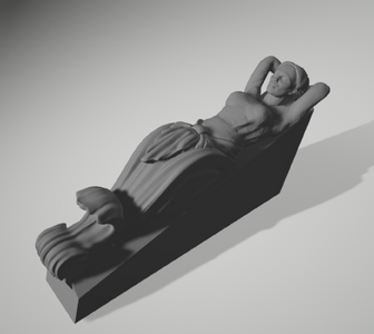

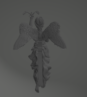

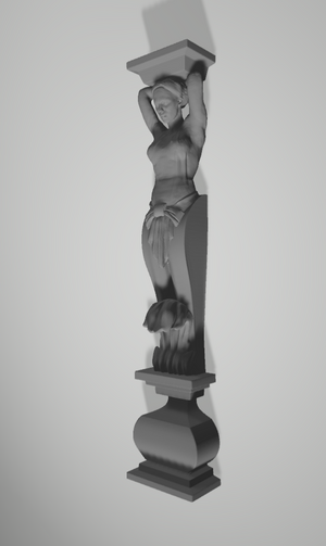

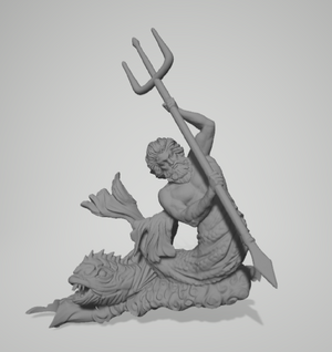

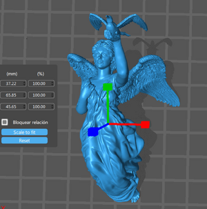

3D printers can produce incredible details (provided that the artwork is done properly). Unfortunately most of the 3D sculptures have to be painted which is not in line with the requested finish sometimes. And a primer and one or two coats of the chosen colour have to be applied, so, depending on the scale, the smallest details could already be gone.I know this from my experience with the Batavia kit from Kolderstok which had beautifully detailed sculptures 3D printed but in blue colour. My comment was there and is now, given that an awful lot of printing materials are available, with timber option among them, why can't the sculptures be printed in timber colour so, if needed, they could be used without painting? I know of course that 'timber' colour does not mean anything, as we have to talk rather about oak or elm or walnut or whatever but a generic 'timber' colour could surely be found.
