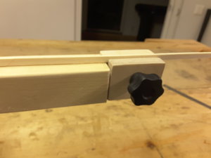

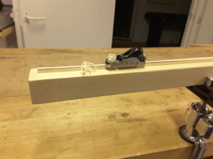

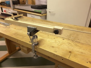

When talking about tapering the planks, you might be interested about the jig I made of a length of 40x40 mm wood & small piece of 12 mm plywood and a knob wheel attached into short piece of threaded rod (M8).
The plank to be tapered is squeezed between the "jaws", and tapered using the wonderful Veritas small plane:
