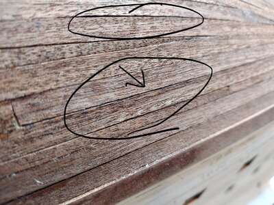

I am building the Le Soleil Royal and am in the 2nd planking layer. It is Sapele wood and am using pvc glue.
The problem is the edges of the planks are curling up a bit since it is so thin and I imagine it’s the water in the glue causing this. Whatever the reason, is there a way to prevent this?

The curling is not severe it’s just that you can see it up close and when you run your hand over the hull.
I do use Lineco white neutral ph glue and that works very well. Used it on the decking with no curling at all. But does curl on these.
I even tried the Titebond but still curled. The curling actually begins BEFORE I even get the board to the hull. I also use a wallpaper roller but doesn’t help too much with this problem.

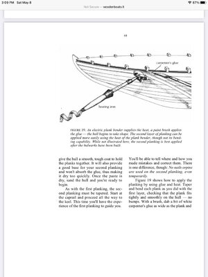

Wow! You just sparked my senior brain. I now remember reading this from “woodenboats.it” on planking...they also said to use heat while laying the plank down.
Now where the hell did I put my iron? ;)
Thanks.
